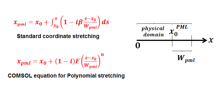

I also want to ask about the PML. Theoretically, we can tune PML by controlling the value of absorbing function. But, COMSOL's implementation of PML is slightly different from that. I am guessing scaling factor can be compared to the absorbing function.

The coordinate stretching COMSOL uses seems a bit different from the standard ones I have seen in the literature (please see the file attached). It looks like COMSOL scales both real and imaginary part. However, I have no idea how the rational stretching works (the equation is more complicated) ! The F (comsol) and beta (standard) work as the absorbing coefficient.

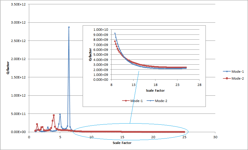

I am calculating Q-factor for the resonator. I don't know what should be the exact value but expect it to be very large. That's why I am looking for a reasonable convergence (for PML length, Scaling factor, no. of elements). At the moment I am using the automatic mesh generation in COMSOL.
The resonator is connected to a substrate, and PML is around that substrate (i.e. substrate is considered semi-infinite compared to the resonator). Trying to absorb the propagating wave to the substrate, hence Q-factor.

I have got couple of questions below, which is making me confused. I hope you could help me out:
1) Selecting a decent PML width and changing the scaling factor (SF) gave a reasonable convergence. But sometimes after achieving a convergence the Q starts diverging (although not that significantly) as SF is further increased. Could this be due to spurious reflections?
2) What about the number of elements, when SF is increased? In my case I used a fixed number of elements and vaired the SF.
3) What is the purpose of PML scaling curvature parameter?
4) Since, optimal PML width may be difficult to find (when wave length is large) by varying the PML width, I chose to increase the SF instead and look for convergence. Please comment on this approach.

1) Working with UPMLs, if you exaggeratedly increase the PML absorption (which I believe is equivalent to increase the SF) what you will get is a PML that has a high absorption. Like a metal, therefore you will have also reflections. That may explains why your Q diverges after increasing too much the SF.

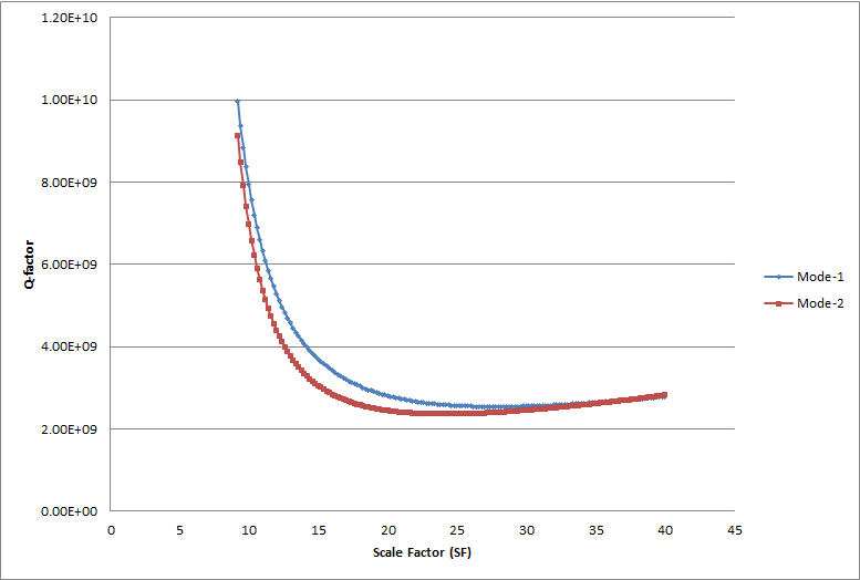

Thanks for you reply. I have attached a graph of my Q-factor vs scale factor. Generally the two modes are expected to have similar Q values. But there's a difference between two Q values initially. As SF is increased further two values become similar BUT you could see the divergence of the two curves. I hope you could give some suggestion on that.
Also, how accurate are cylindrical/spherical pmls compared to rectangular ones?
What you show in your graph is, I suppose, the expected behavior for a PML:
If you put a low scaling factor, it is similar to put a low-absorption boundary condition. Then the outgoing waves will go in and out of your PML causing spurious reflections.
If you put a high scaling factor, it is similar to put a very-absorptive boundary condition (high conductivity) and it will behave as a metal, which will translate also in spurious reflections.
PML success, as in live, depends on having the exact amount of each ingredient... that is why PMLs are perfect :)
There are lots of papers about how to tune the PML parameters. I dont know any of them applied to the area of MEMs or Structural Mechanics, but I'm sure a simple search will lead you in that way.
If I were you, wouldn't waste more time and start using a scaling factor between 35 and 40.
