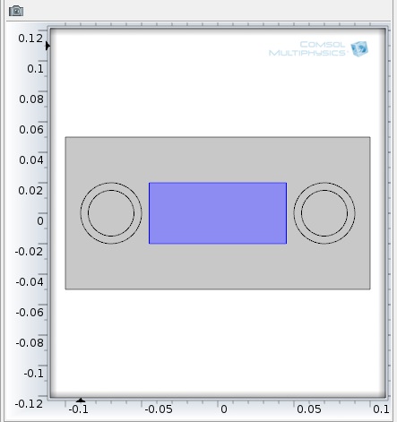

Hi everyone,
I am trying to simulate single channel biological tissue spectroscopy..... I use AC/DC model and I want to make excitation coil which produce electromagnetic filed and in the other side I design a detecting coil ,,,,, and between them I design biological tissue (muscle tissue), but I have problem in the parameter of the muscle tissue .... can someone help me to set the parameter of the muscle tissue???

Azmi,
niremf.ifac.cnr.it/tissprop/
This site provides a wealth of electromagnetic biological tissue properties.
Cheers
Edgar
