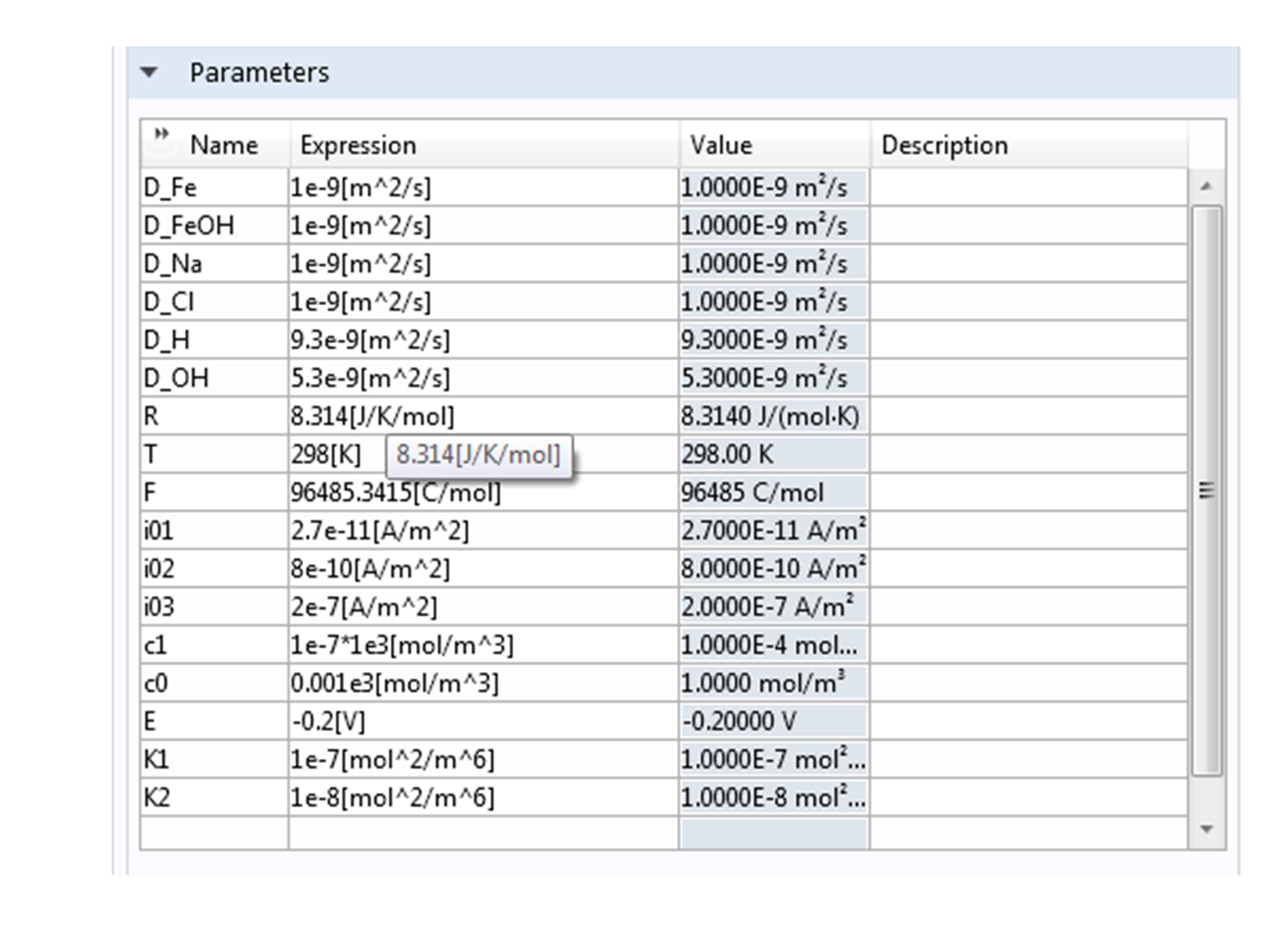

Your definition of the conductivity, k, had a small error. In the conductivity the charge numbers are raised to the second power, hence there are no negative terms in the summation.

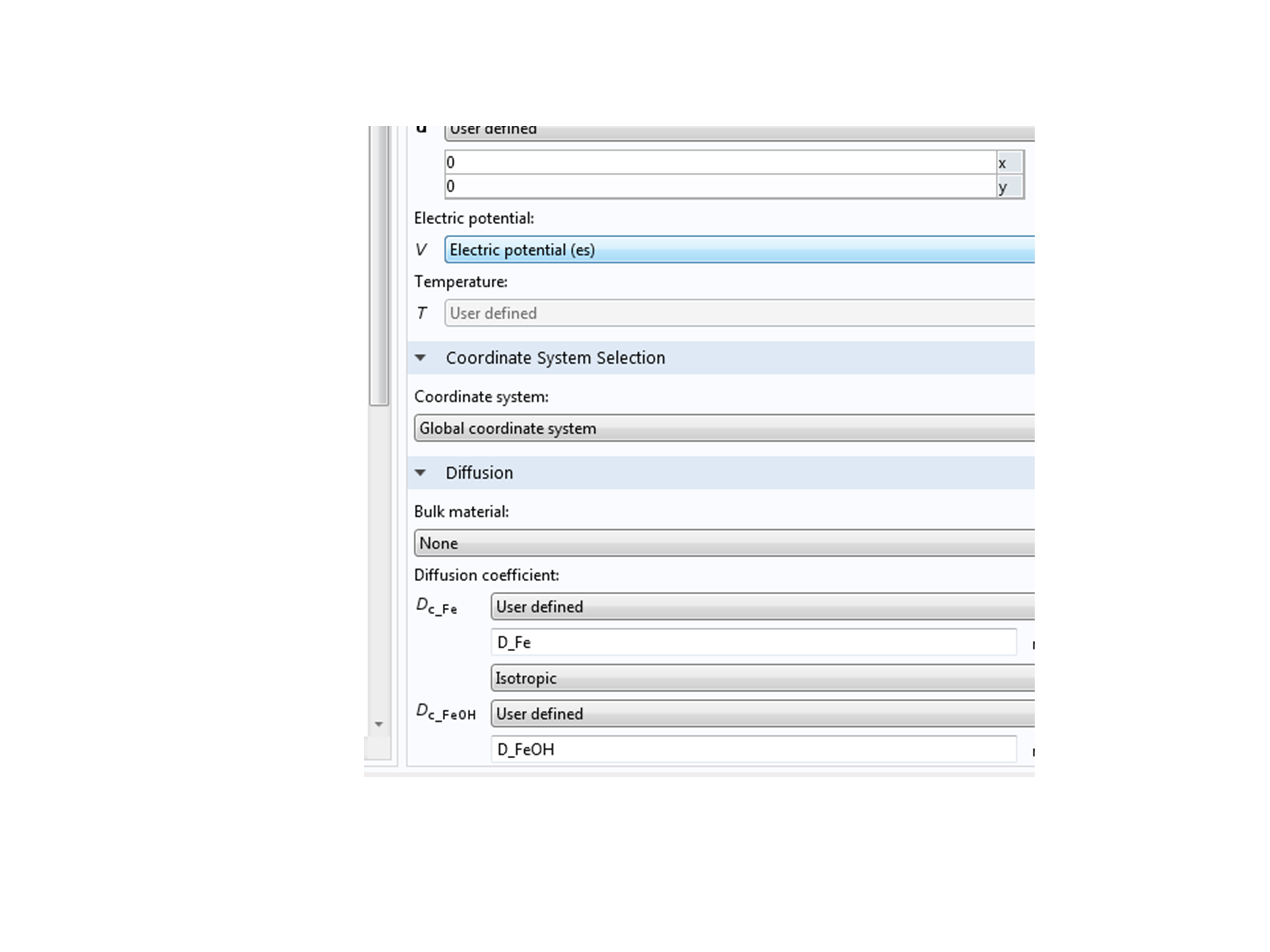

In the node Transport of Diluted Species you have to couple the voltage variable V from the electrostatics node, see figure.
The solution converged, but I do not understad what you are simulating. Everything is constant in the solution plots. Why cannot you use Nernst-Planck equation instead of diffusion and electrostatics separately?
