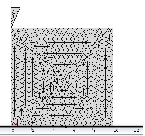

I am having difficulties in meshing and I know it could require some tricks. Currently, I have a contact pair where the upper part goes into the substrate with a prescribed z- displacement of 0.2 um (Please see the attached picture).
I am able to get solution with no problem when I choose "physics controlled mesh" with an element size "finer". However If I go to "extra fine", the solution does not converge. Considering my small displacement, I would like to have finer meshing around the corner of my substrate and coarser as I move away from the contact area.
Can any of you give me any hints what I should start looking at regarding having this custom meshing technique where particular local area inside a square substrate is much finer as compared to other parts ?
