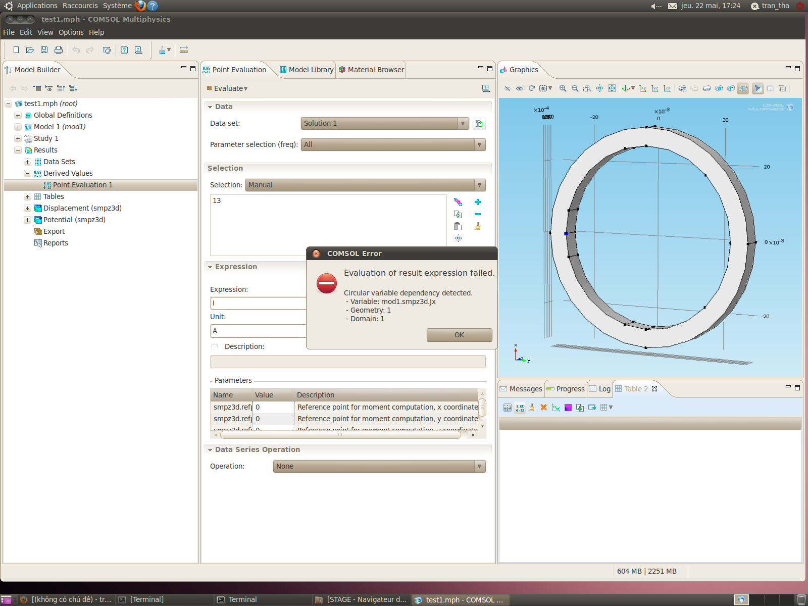

Error circular variable dependency detected
Posted 2014年5月22日 GMT+8 23:24 Version 4.3a 0 Replies
impedence = V/I
I = mod1.intop1(intcpl_source_i) (variables in Global Definitions) , intop1 is integration in Definitions
intcpl_source_i = -imag(ampz3d.nJ) (variable in Definitions)
but when calculating the current through the surface of the ring, the error appears:
Evaluation of resultat expresion detected
-variable : mod1.smpz3d.Jy
-Geometry : 1
-Domain :1
I don't understand why ? you can help me ?
