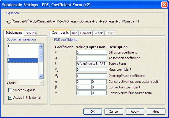

Here is what I have done...
Use the PDE, Coeffient Form (c)
Select the subdomains that will be active for the calculation... In Roberts case, the tissue...
Set f (source term) to A*exp(-deltaE/(R*T))
Set da (damping/Mass coefficient) to 1
All other variables to 0
I use Omega for c when I initiate the physics in the modeler...
Your equation will then be dOmega/dt = A*exp(-deltaE/(R*T)) or rearranged dOmega = integral (A*exp(-deltaE/(R*T)),dt) - see attached...

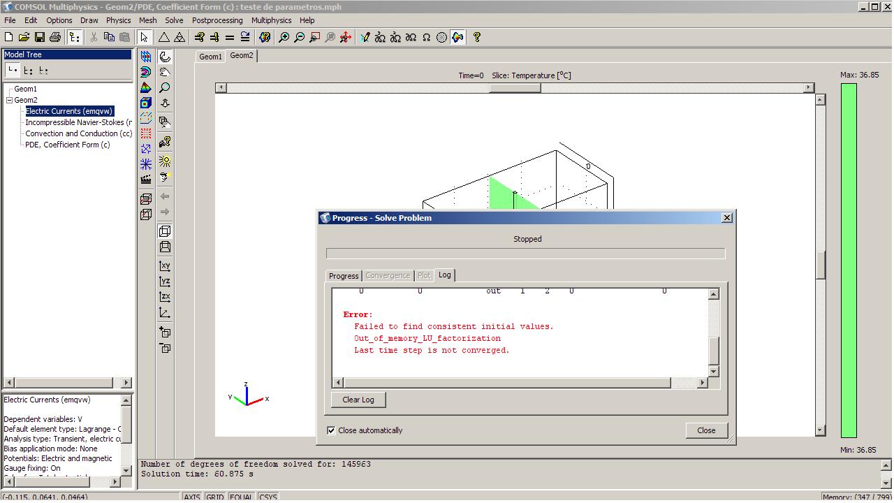

I need help! I am trying to apply an Arrenhius damage integral DURING the solution of an thermal ablation problem using the heat Transfer and PDE coefficient form Modules (T and u are the dependent variables). In the end of the simulation, it appears the following message:
"Error:
Failed to find consistent initial values.
Out_of_memory_LU_factorization
Last time step is not converged."
Any help is WELCOME!

Posted: 1 decade ago 2012年4月25日 GMT-4 16:46
Have you ran the simulation with the PDE, coefficient Form(c) disabled? Does the simulation run without the PDE?
It has been a while since I implemented this but I do not remember a u variable.... Only Temperature. What are you using for Ea and A?

Posted: 1 decade ago 2012年4月26日 GMT-4 12:36
Hi Jason!
I have committed a mistake: I forgot to inform the description of fluid mechanics on my simulation. Actually, I am using the heat transfer, PDE coefficient Form(c) and incompressible Navier-Stokes modules. The u variable describes the fluid velocity in this last modality of Physics.
The values for Ea and A are:
Ea=6.65x10^5 J/mol;
A=1.98x10^106 1/s
The link below illustrates the window of the software COMSOL:
www.comsol.com/community/forums/general/download/file/12973/error%20Failed%20to%20find%20consistent%20initial%20values.JPG
Sincerely yours,
Cleber Pinheiro

Have you been able to run the thermal/fluid interaction without the Arrenhius damage integral? If the thermal/fluid interaction does not solve, that may be where your error is coming from.
