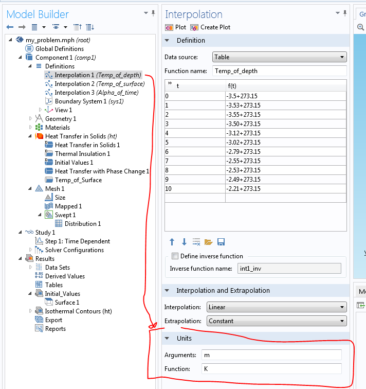

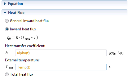

It did you mean? (see pict.) But this dont work.

Regarding your screenshot, you need to specify the functions under definitions before you can use them. As you did not include your whole model, I have no way of seeing what you did there.
Please add the model so I can see what is happening there.
best regards,
Frank
I notice that you only got a warning (yellow) for the functions because of the units that were inconsistent. You can usually ignore that, but I attached your file where I fixed it for you.
Under the functions, you can fill in the units of the arguments and the function itself.
Note that you can also specify that the output is in degC, and then you can skip the +273.15.
Furthermore I slightly adjusted your mesh to better follow the changes in the time.
And I set the interpolation of the functions to "piecewise cubuc", this smoothens out the function so the derivative is continuous as well.
