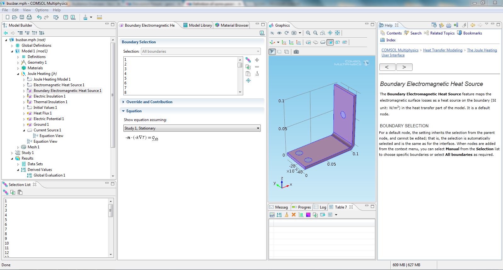

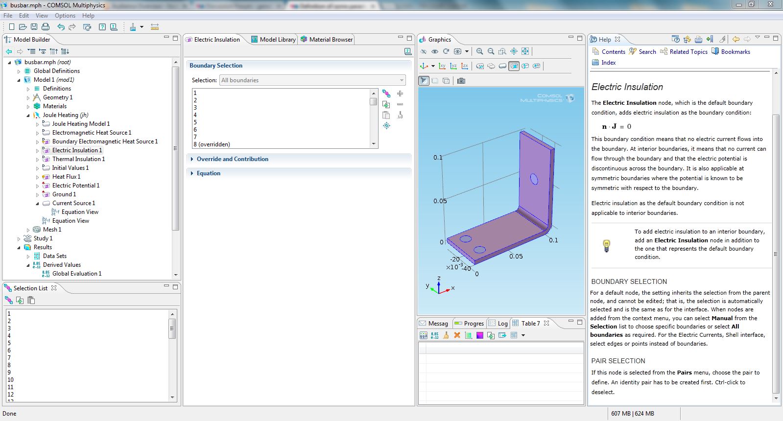

2- Under boundary electromagnetic heat source, what is Q_sh and since we have another boundary condition for electric field such as electric insulation, why we need boundary electromagnetic heat source?
