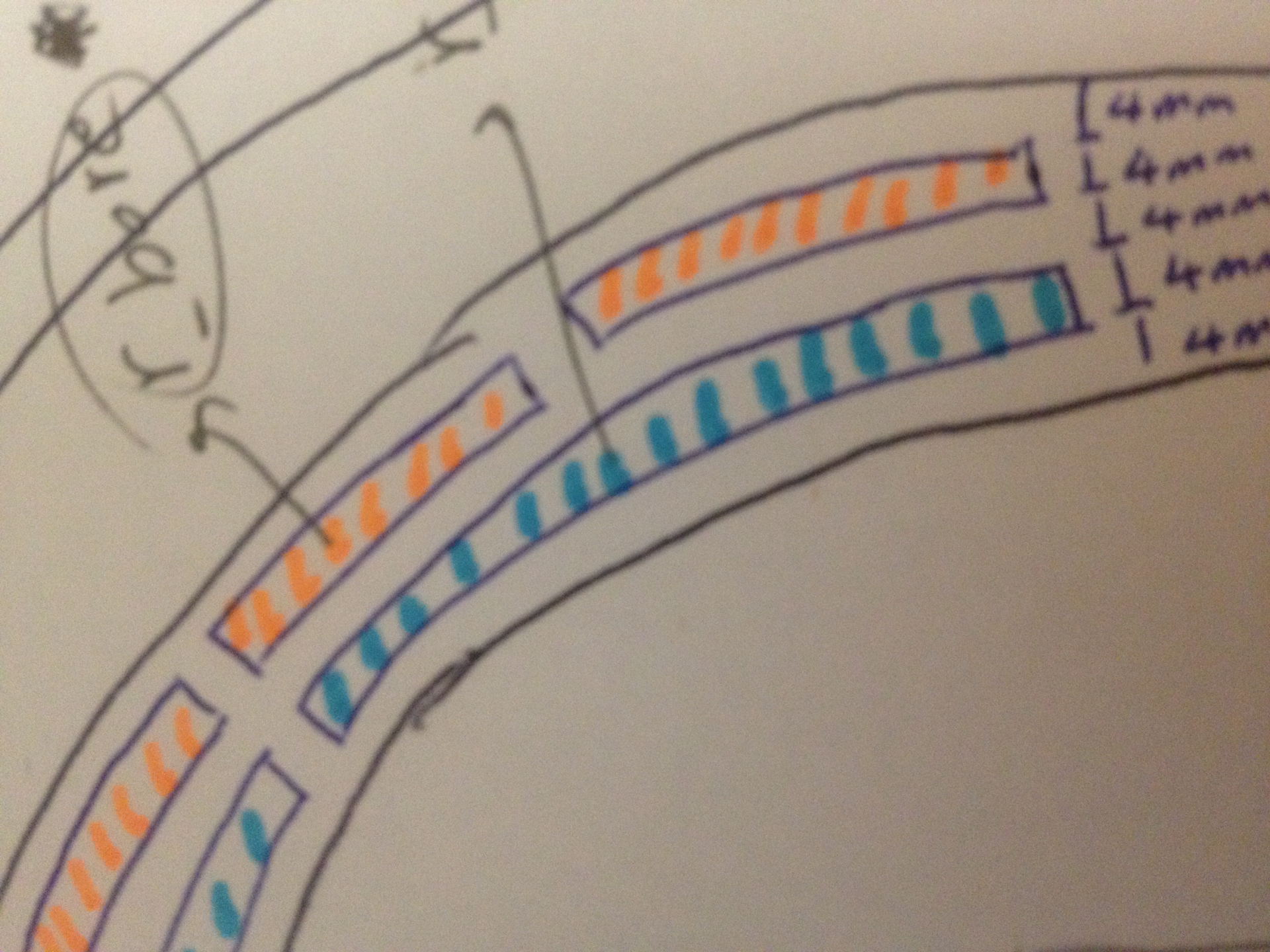

Hi everyone,First of all I'm using comsol 4.4. my design have several spheres around the same centre,and I'm trying to create curved rectangles ,among two spheres,can you help me please?

thank you for you great help,I'm working in 2D area ,and I attached the picture,that I exactly want to draw,these blue and orange areas are supposed to be like pipes at the end.
The fillet option didn't work cause it curved the width of the rectangle ,is there a way to curve the length of it?

the circle geometry allows you to define a sector angle and a rotation. This allows you to draw the curved parts using two of those partial circles with a radius difference of 4mm. Using sector angle and rotation, you can then calculate the endpoints of the arcs and connect with lines, polygons with two points.
You only have to create one of those objects and then rotate it using an array of rotation angles. I would recommend to use a parameter table, so you can automatically reconfigure the pattern if needed. In the parameter table you can also do the trigonometric calculations.
