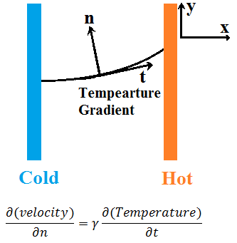

I have a curved Liquid/Vapor interface with temperature gradients both in x and y directions (See the attachment).
Does anyone know what to do if I want to impose a 2D boundary condition on the interface?
I came up with these assumptions but not sure if they are correct:
test(u)*(gamma*dtang(T,x))
test(v)*(gamma*dtang(T,y))
I appreciate if anyone can help.
