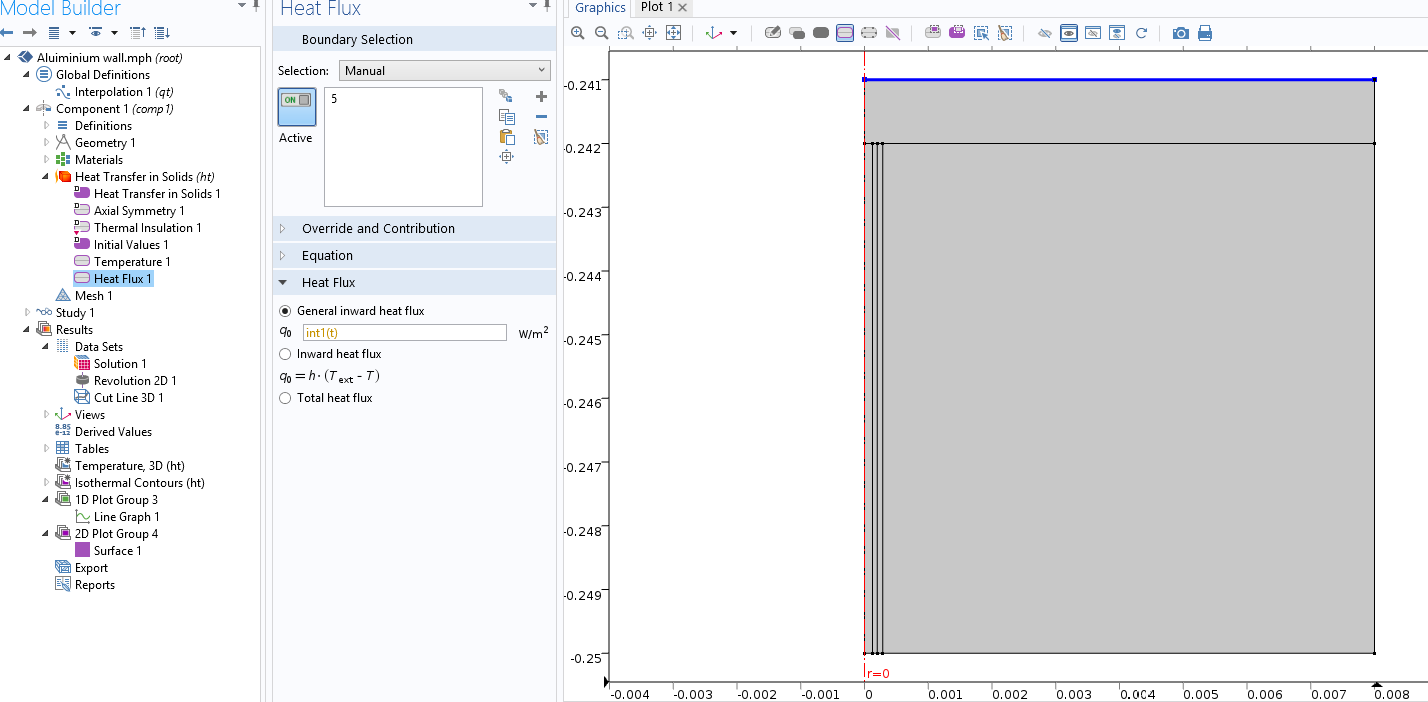

For my project I have built a simplistic 2d axis-symmetric geometry (effectively forming a cylinder) and on the top surface I want to define the net inward heat flux as a function of time.
Firstly I have defined a global interpolation function that describes the variation of heat flux with time and have named this function "qt".
Next I have set the boundary condition on the top surface as a general inward heat flux, but I cannot figure out how to define q0 as the function qt(t)
any help would be much appreciated!
