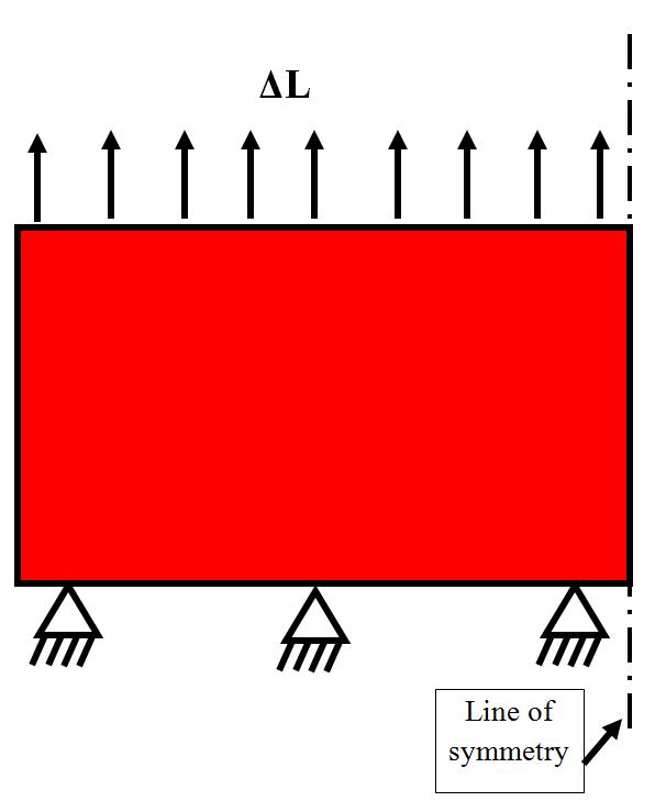

Hi all,
I am trying to run a simulations in which the geometry is 2D and it consists of a rectangular shape with slots in the middle. to make it simpler , lets just consider it as a rectangular sheet with some thickness. Refer to attached figure. A displacement is applied on the top edge while constraining the bottom edge in all directions. the right edge is a line of symmetry as the rectangle is considered symmetrical about that line (just to cut down the size and memory while solving).
I want to model this as a elasto-plastic material and it should follow a multi-linear stress-strain curve rather than a bilinear. the values of the multi-linear curve are known.
I want to apply a prescribed value of displacement in the upward and downward direction (tensile and compressive) alternatively. this is generally to generate a hysteresis curve for the model.
please suggest me on :
1. how to provide the Kinematic hardening multi-linear stress strain curve values to define the material model.
2. the procedure in which i can apply the alternating tensile and compressive displacements in the top end.

Hi:
It's possible to define your own stress-strain curve. Just add a function (Options->Functions...) and tabulate your S-S data in there. With that, you'll have a plot of your material behavior. Once you have that, you can add a scalar expression for the hardening function. That should cover it. There's a very good tutorial for this on the Structural Mechanics Module's User Guide, Chapter 4, page 122. In there you can see a step-by-step guide of how to do it.
As for the alternating loading, you could use a transient analysis with a time-dependent sinusoidal wave for the displacement, or a function with alternating values, or maybe a parametric analysis that uses the previous solution as the starting point for the next iteration.
I hope this was the answer you needed.
