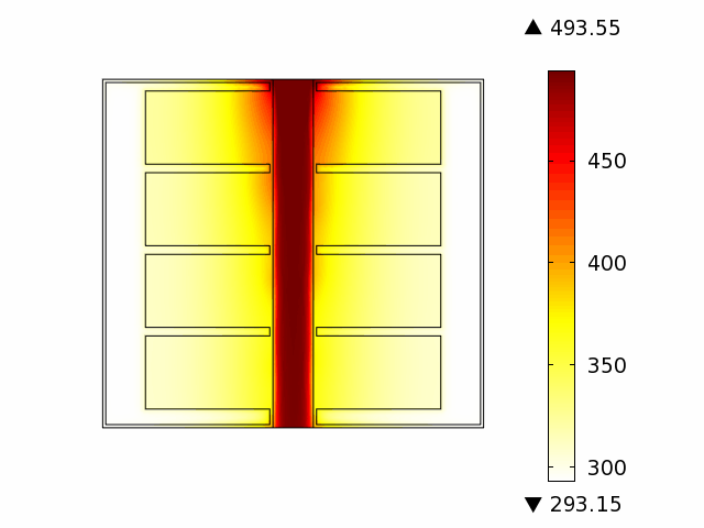

Lechoslaw Krolikowski
Posted: 1 decade ago 2011年11月10日 GMT+8 01:40
I've run your simulation. It looks fine. See attached files. Animation shows how heat penetrates from water to aluminium and SS. Plot of average outflow temperature vs time shows that water loses heat.
Andrzej
Hi, I've run your simulation. It looks fine. See attached files. Animation shows how heat penetrates from water to aluminium and SS. Plot of average outflow temperature vs time shows that water loses heat. Regards, Andrzej
Carlos Perez de la Blanca Castellano
Posted: 1 decade ago 2011年11月10日 GMT+8 02:01
Hi Andrzej,
That you for looking my model.
I dont understand.Looking at the plot Av-Out vs T,i see that the temperature of the fluid increases until 493K,so its not loosing heat,and in the other plot the entire pipe its at the same color.The fluid temperature at the end should be inferior than 493K,isnt it?
Could you explain me?

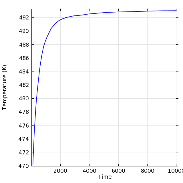

AND HOW DID YOU DO THE OUTvsT PLOT??Thanks
Hi Andrzej, That you for looking my model. I dont understand.Looking at the plot Av-Out vs T,i see that the temperature of the fluid increases until 493K,so its not loosing heat,and in the other plot the entire pipe its at the same color.The fluid temperature at the end should be inferior than 493K,isnt it? Could you explain me? Thanks, Best regards, Carlos AND HOW DID YOU DO THE OUTvsT PLOT??Thanks
Posted: 1 decade ago 2011年11月10日 GMT+8 05:14
In the limit, when time tends to infinity, the temperature tends to 493K (inflow temp.) in all domains and the rate of heat transfer goes to 0. Under these conditions (steady state) the outflow temp. is equal to the inflow temp.
How to get the plot of average outflow temp. vs time?
Under the Results node right-click Derived Values. Choose Average > Line Average. Line Average window appears. Under Selection choose boundary 28. Click = icon (evaluate icon). In the Results window (right-bottom corner) click Plot icon.
Andrzej
Hi, In the limit, when time tends to infinity, the temperature tends to 493K (inflow temp.) in all domains and the rate of heat transfer goes to 0. Under these conditions (steady state) the outflow temp. is equal to the inflow temp. How to get the plot of average outflow temp. vs time? Under the Results node right-click Derived Values. Choose Average > Line Average. Line Average window appears. Under Selection choose boundary 28. Click = icon (evaluate icon). In the Results window (right-bottom corner) click Plot icon. Regards, Andrzej

Posted: 1 decade ago 2011年11月10日 GMT+8 14:27
Hi Carlos
take a look, you have a flow of 0.5 m/s your device is only 0.45m long, then you look at the temperature after 50 seconds, the fluid has passed 100x the length of your device, that is why the fluid appear at more or less constant temperature. Try a stepping time much shorterr at the beginning like 0.1 0.5 1 2 seconds and you will see better effects. By the way have you checked your mesh size, time stepping, heat diffucivity and heat capaciyt time constants, and their coherence across your model ?. Chekc a book on the Biot number and the time constants for yout thermal analysis, as well as the fluid Renolds, Prandtl and Nusselt number, all these are also useful to check the validity of your model settings
Hi Carlos take a look, you have a flow of 0.5 m/s your device is only 0.45m long, then you look at the temperature after 50 seconds, the fluid has passed 100x the length of your device, that is why the fluid appear at more or less constant temperature. Try a stepping time much shorterr at the beginning like 0.1 0.5 1 2 seconds and you will see better effects. By the way have you checked your mesh size, time stepping, heat diffucivity and heat capaciyt time constants, and their coherence across your model ?. Chekc a book on the Biot number and the time constants for yout thermal analysis, as well as the fluid Renolds, Prandtl and Nusselt number, all these are also useful to check the validity of your model settings -- Good luck Ivar

Posted: 1 decade ago 2011年11月11日 GMT+8 00:09
Why do the domains tend to 493K if the intial value is 493K??
CAN I DO A PLOT "OUTFLOW TEMPERATURE vs TIME" or it doesnt have sense?
Initial temperature of Al+SS domains is 293K as you can see in Prueba Conjugate HT.mph.
Hot water of the constant temperature 493K flows into your system. All outer boundaries (exept inlet and outlet) are insulated. Therefore, the final temperature of all domains (H2O+Al+SS) must be 493K irrespective of the initial temperature.
Outflow temperature Tout is a function of the two variables: t (time) and x-coordinate. You can plot Tout vs t fixing x or
Tout vs x fixing t.
Andrzej
