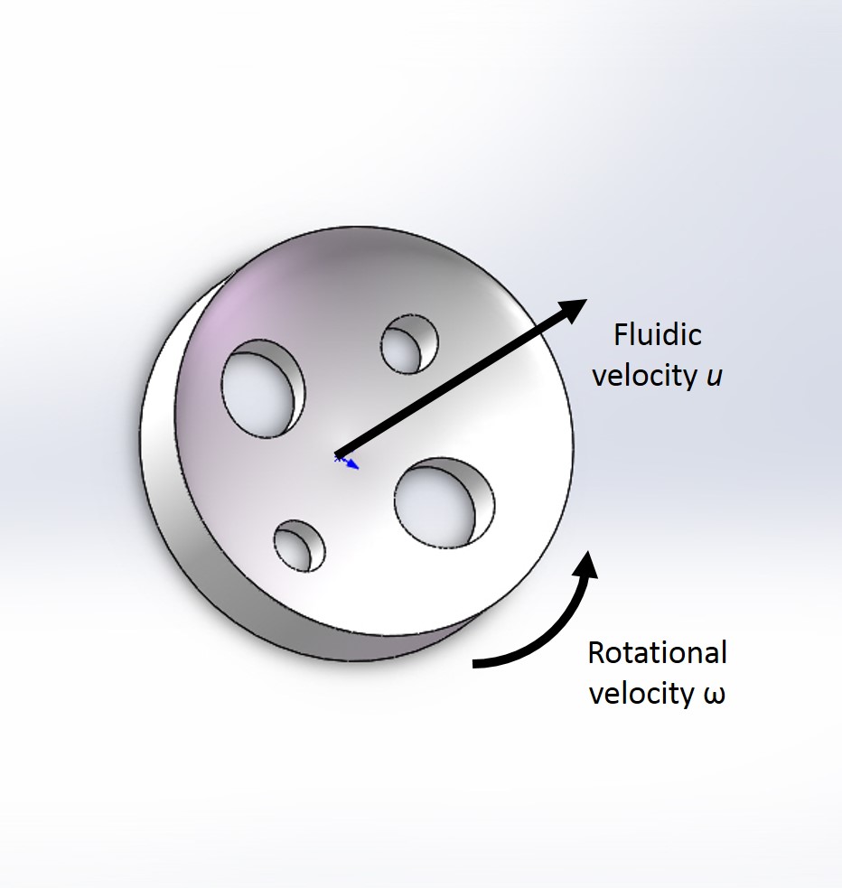

Hi everyone. I wanna build a model based on the fluid dynamics. I want to know the fluid shape when the water through one rotational disk, which has four holes. Could you just give me a little clue?

The "Rotating Machinery, Fluid Flow" physics interface will probably be suitable for your problem. Check out the "baffled mixer" example in the model library to learn how to use this physics interface.
