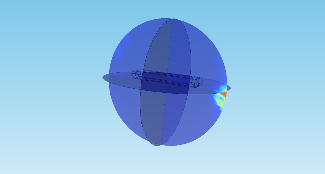

I have a simple geometry and I want to find the inductance and the resistance of the same. However, I do not understand why the computation takes so long for this. I wasnt able to compute fully due to processing ability of my PC. However, according to me, it should not take long.
www.dropbox.com/s/kktoh7c3rpxqam6/PCB_3Dmodel2.mph?dl=0
Can someone help me in explaining where I am going wrong ?

as far as I can see the moel does not contain a single turn coil or any other closed loop
structure but rather a plate.

Dear Sven,
Thank you for the reply. However, it is not exactly a plate, but the distance between the two plates is very small (in um) as compared to the length and breadth. If you zoom and see, i think you can see it.
Thank you.
Anup
Dear Sven, Thank you for the reply. However, it is not exactly a plate, but the distance between the two plates is very small (in um) as compared to the length and breadth. If you zoom and see, i think you can see it. Thank you. Regards, Anup

I downloaded your model and just ran it. It took 2 mins and 3 secs. I have a three year old laptop with 8 GB RAM. If you have less than that, 3D models do not run smoothly.
br
Lasse
Hi I downloaded your model and just ran it. It took 2 mins and 3 secs. I have a three year old laptop with 8 GB RAM. If you have less than that, 3D models do not run smoothly. br Lasse

Dear Lasse,
I am running this on my university server, which I think has a 128 GB RAM. I am not sure as to why it takes so much time though,
Can you please send the file, with the mesh and the results . I will check it now.
Anup

Posted: 1 decade ago 2015年4月13日 GMT-4 07:06
I did not change anything, it is your file. The problem may be in the temporary disk size allocated to you. Check your comsol.ini file.
Lasse
I did not change anything, it is your file. The problem may be in the temporary disk size allocated to you. Check your comsol.ini file. Lasse
Posted: 1 decade ago 2015年4月13日 GMT-4 07:08
check out the no. of degree of freedom of your meshing model. if this is a large no. then you definately get more time for simulation.

Posted: 1 decade ago 2015年4月13日 GMT-4 07:18
hey its finely simulated in just 2-3 minutes or less.
check your comsol core settings if u changed......
hey its finely simulated in just 2-3 minutes or less. check your comsol core settings if u changed......

Dear Yoginder,
I havent changed the settings. I am now looking into what could have gone wrong. It has taken me 40 mins now and the computation is still not over.
Thanks a lot for your help. :)
Anup
Dear Yoginder, I havent changed the settings. I am now looking into what could have gone wrong. It has taken me 40 mins now and the computation is still not over. Thanks a lot for your help. :) Regards, Anup
