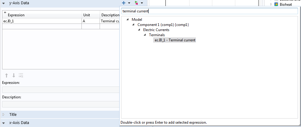

Luckily you do not have to memorize the expressions, because when you click the button in the upper right corner of the expression box a list of possible variables is shown with explanations in plain English.
But I agree, they are very difficult to remember.
br
Lasse

Yes, and in the list of variables you can search for variables. Typing, for example, "terminal current" filters the list of variables so that only
ec.IO_1 - Terminal currents
appears.
In the naming scheme, the ec. part of ec.IO_1 indicates that the variable belongs to the Electric Currents interface called ec.
appears.

Ah that is actually helpful, thanks. I didn't know we could click to see a list and search :)
