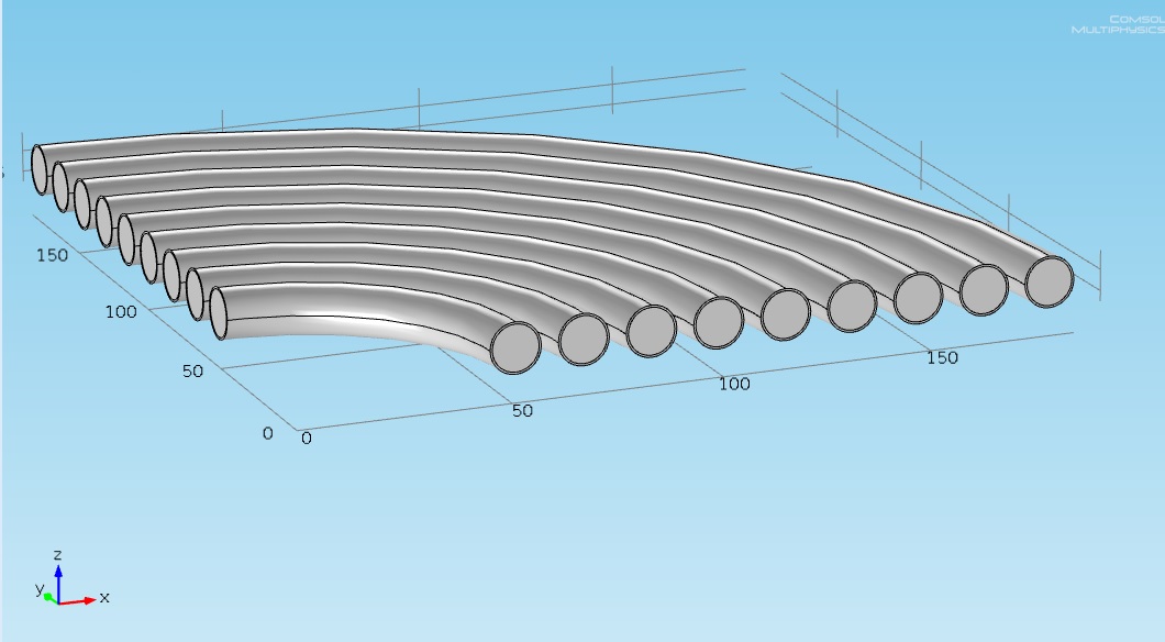

I always set the current in the solid coils setting one terminal to x Amperes and the opposite one as ground. But now im working with inductive pipes -hollow wires as seen in the jpg below- and I dont know if im setting the current in the right way.
How would you make the currents flow in this system? Im a bit lost, Im afraid. Is there a better way to set currents apart of the terminal/ground system?
I cant work in axysimetric because the porpuse is to set non-simetric elements later.
Thanks a lot.
