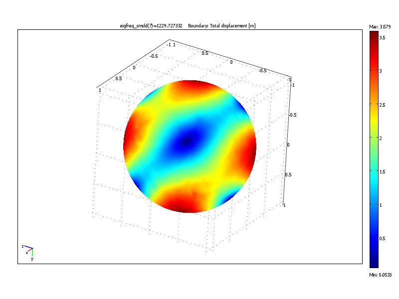

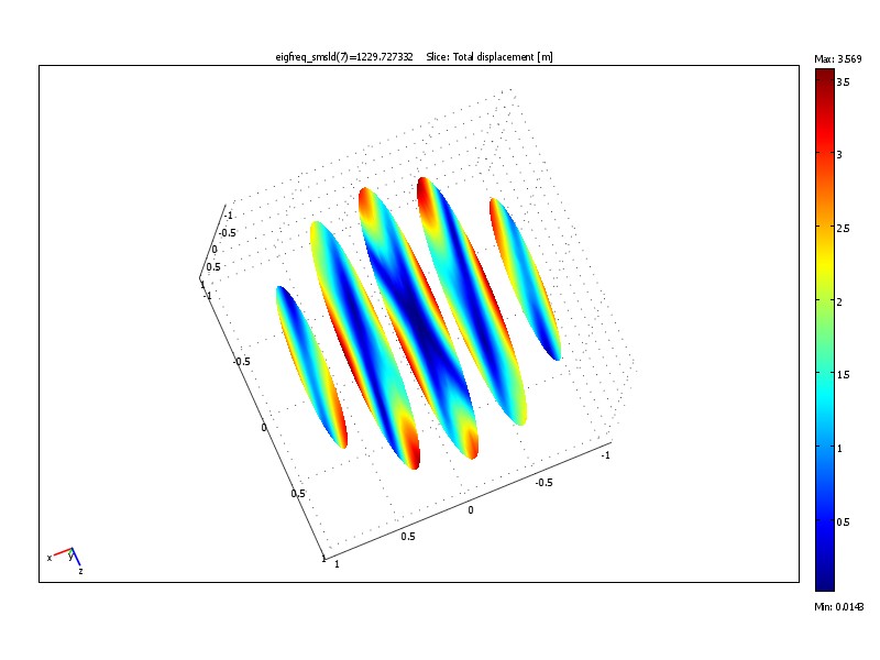

Structural Mechanics Module ->Solid, Stress-Strain -> Eigenfrequency analysis -> create a solid sphere of 1m -> set boundary constraint condition as Free -> Set Subdomains with default setting (E=2.0e11); v=0.33; a=1.2e-5; p=7850), Material model as isotropic; Coordinate system as global coordinate system; ->initialize mesh - Solve eigenfrequency -> that is.
I used Slice (predefined quantities=total displacement) to check all the frequencies found from 0-4000Hz, but were not able to find the breathing mode...
did I do anything wrong here? Help please

Most advanced FEM softwares, and COMSOL too, accepts free objects (fully unconstrained volumes without BC) for their eigenmode calculations, but then the first 6 dof (in 3D) are at "0" [Hz] or close to, as the unconstrined object can move/rotate freely along the first 6 dofs (x,y,z, Rx,Ry,Rz).
By default COMSOL provides you with the results of the first 6 modes, you have to manually set a higher limit, i.e 12 or more to see the modes above. See the solver setting page.
So normally you do not need to set any BC, especially how would you, on a sphere like that, without influencing the modes ?

thanks for your reply. I still had troubles in understanding results from Comsol. here are some more information on "breathing mode".
(1) the breathing mode of a sphere means sphere only experiences radial motion. the fundamental breathing mode of a free sphere corresponds to an expansion and contraction of the sphere along radial direction oscillations with the lowest frequency (n=0 mode). I attached an image here showing analytical calculation of n=0 and n=1 breathing mode of a sphere.
(2) As I described before I tried to use Comsol to calculate breathing mode of a sphere (R=1m with default material setting, see above), but I was not able to find the fundamental breathing mode. I attached result from comsol calculation here with lowest frequency at 1229Hz. as you can see from both slice and boundary images (total displacement) it was not so called breathing mode (which was supposed to have spherical symmetry in the motion).
would it be possible that I didn;'t use larger mesh size? becasue of limitation of my computer I was not able to set larger mesh size though.
(3) you mentioned about the "deformed shape" image in your message, but I can not find it with comsol 3.5a. would you describe a little bit more detail? I only found x-displacement, y-displacement, z-displacement, total displacement and etc in the predefined quantitied...
another question related to this: my understand is that Comsol did such calculation in cartesian (x-y-z) coordinate. can we select spherical coordinate instead?
(4) another thing I questioned about the result from comsol was that if you looked at my attached image of 1229Hz mode, the total displacement of sphere at that mode could be up to 3.5m for a R=1m sphere. does that make sense? it seemed to em the oscillation amplitude should not be that big...

I do not have time just now to answer all your questions (I'm in fact at a Comsol course, RF this time), but I have a few easy points to give you here:
Eigenfrequencies calculations: the eigenfrequencies calculated are correct from the model point of view in Hz, but total displacements are arbitrary, as eigenmode can be arbitrary normalised. COMSOL has selected one way, rather different from some other fem tools such as NASTRAN and ANSYS, but it's still mathematically correct, so you should not concentrate on the absolute values of a mode shape, only their relative shapes.
As you are interested only in the radial displacements, try to create the integration variable
Duvw dist_smsld
over your spherical volume , then hit "Solve Update Model"
I assume you are in the smsld application mode, and there dist_smsld = sqrt(u^2+v^2+w^2) the total displacement, furtmore I'm assuming your radial origine is at x,y,z=0,0,0, you will need to adapt the formulas if this is not the case
Search for the first mode with largest radial displacement, i.e. plot Duvw over the modes by:
goto the "Postprocessing Domain Plot, General tab: select all modes, select "keep plot", Point tab: select any point, and type for the Expression Duvw then OK

Back to your 3D simulation, I repeated it quickly, default 1m radius sphere, no BC, default material steel. I meshed it rather "finer" with 55000 elements and 231873 DoF's. It took 352 seconds on 8 core for 9 GB ram in direct defauilt settings mode. I asked for 26 first eigenmodes, and what do you see:
Observe the mode shapes in "Slice" mode with 3/1/1 slices and alternatively in "Boundary", with "Deformed" shape ON
I get 6 modes close to "0" Hz, these are the 6 free-free DoFs, as expected;
then 5 modes around 1232+/-0.5 Hz, the shape appears rather spheric with several hills appearing, allthough the numerical values shown are large, but this could be a mode normalisation effect
then 5 modes around 1305+/-0.5 Hz, the sphere show large elliptic deformations, more like an egg,
then 2 modes around 1767 Hz, 1 at 1777, 2 at about 1900, 2 at 1903, 2 at 1905 and one or more at 1912 Hz
with a larger mesh and less elements you will just see more dispersion on the frequencies
