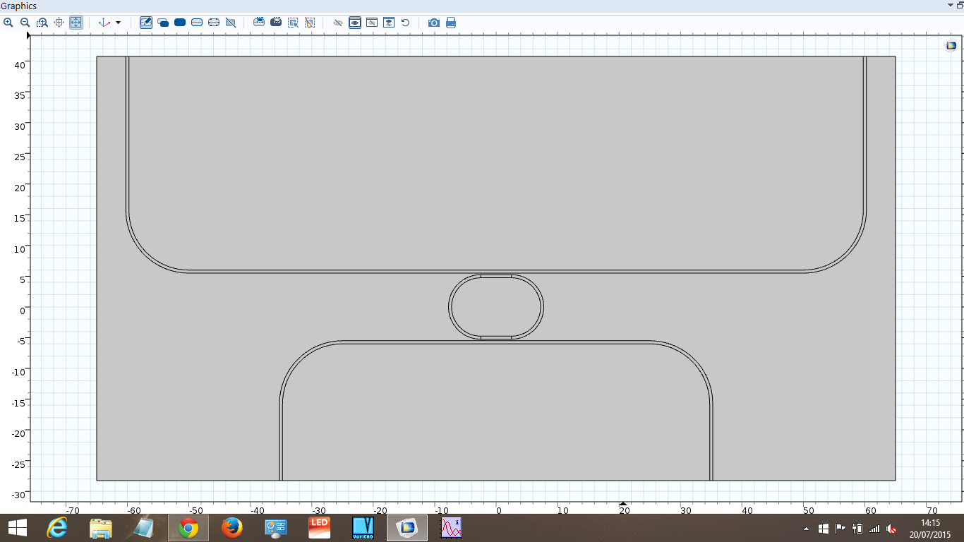

Hello everyone,
I have a big doubt about whether it's bettere to use the Beam Envelope or the Frequency Domain Physics to model an optical Add-Drop filter.
I need to simulate the behaviour of the coupling between a waveguide, in which the input wave is fed, a MicroRacetrack Resonator (MRR) and another waveguide from which it's possible to collect an output. I need to evaluate the coupling efficiency in a range of wavelengths (typically from 1500 to 1600 nm) and with varying MRR geometrical parameters.
The geometry is shown in the picture, the mesh has been set to Free Triangular with different maximum element size for the core (waveguides and MRR, silicon) and the cladding (air) material, depending on the refractive index.
I tried to follow the examples in the Model Library both for the FD and the BE physics but, while the former has a huge computational weight, the latter doesn't converge.
Any suggestion is appreciated.
Thanks.

Hello Silvio,
You will want to follow the approach outlined in this example:
www.comsol.com/model/optical-ring-resonator-notch-filter-22221
Also make sure to look at the meshing techniques outlined in this example:
www.comsol.com/model/mach-zehnder-modulator-15061

Thanks for your kind answer. I am trying to replicate the example in my version of COMSOL (v5.0) but the function "Field Continuity" is not available due to its implementation in version 5.1: given that I cannot update it (I am not a system administrator), is there a way to overcome this limitation?
Thanks again.

Dear Silvio,
We do recommend that you upgrade to COMSOL 5.1 for this type of analysis, yes. This Field Continuity feature is newly implemented in 5.1, and the upgrade is available to all on-subscription users.
Dear Silvio, We do recommend that you upgrade to COMSOL 5.1 for this type of analysis, yes. This Field Continuity feature is newly implemented in 5.1, and the upgrade is available to all on-subscription users.

Thank you, I just obtained the upgrade to 5.1 and I'm already working on my model.
I have found a strange behavior of the model: abs(ewbe.S21)^2 gives me many values greater than 1. I can't understand wether it's plainly wrong or there's something I can't understand in the way S-parameters work.
