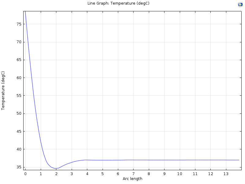

                                                    Hi!
I am modeling the temperature distribution inside a layer of biological tissue. The geomtry is a cube. I put a temperature BC of 78°C on one of the face and a temperaure BC of 37°C on the opposite face. The others face are insulated. I am using the mode BIotHeat equation to model the heat removing by the blood circulation, so I put 37°C to the blood too.
I am writing this post because I think my temperature profile is wrong, indeed I obtain a minimum temperature inferior to 37°C inside the cube and it is physically impossible! The temperature inside the cube should be between 78°C and 37°C and the minimum 37°C. But I remarked that the problem disappear when I use Stationnary equation form in the tab Heat Transfer in Solids. I put in attachment the temperature profile of the cube.
It would be great if somebody could help me!!
Thank you!
Have a nice day!
Tim
