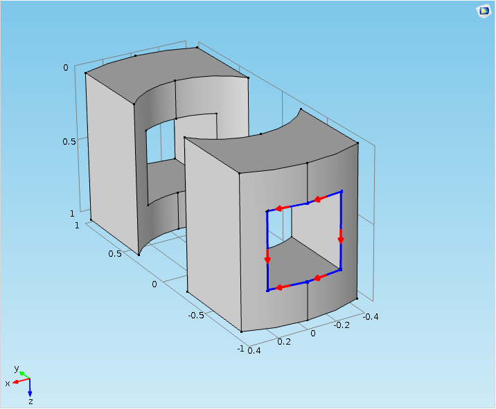

the "Coil Geometry" sub node has undergone a few changes over the last versions so you need to check your ACDC doc carefully.
Normally you should select a "rounded/fileted edge" shape giving the average length of the coil. In your case you have sharp edges and just the internal section, therefore your coil length calculations will be quite wrong, and the loop arrows look also wrong indeed. You could draw a loop (circular or a rectangle with fillets) in the middle of your volumes.
But it looks like you have a deformed coil wit a non planar shape, not sure how to correctly define that. Probably you should send the request directly to "Support".

Hey Ivar,
thank you for your quick reply. Naturally I took a look at some other posts before I wrote down my request in this forum and I am very happy to have a contact person like you - what I want to say: you do a great job; thank you for that.
You are right. It is a deformed coil with a non-planar shape - a saddle coil. I solved the problem by using the multi-turn coil type "numeric" and added a work plane to cut my model for creating a cross section. It is required to select the input of the input subnode of the automatic current calculation subnode. An electric insulation subnode is also required in which I selected all boundary faces of that coil. Furthermore I added appropriate coil current calculation steps to my study.
