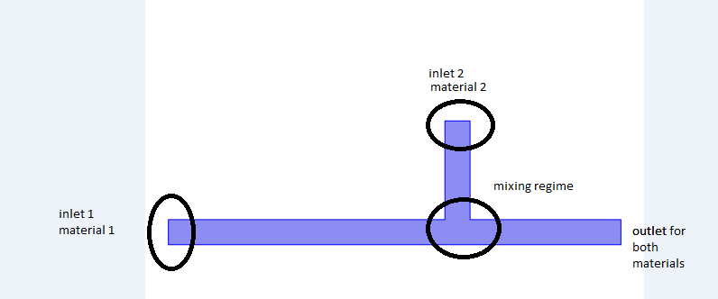

I am designing a reactor in which i want to have 2 different material from 2 different inlet but in the same reactor.
As shown in the attached figure both the materials mix at the T junction and exit by the same outlet.
Can someone guide me which model or physics to be used for that.

Dear Chintan,
please take a look at our tutorial model "droplet breakup in a T-junction":
www.comsol.com/model/droplet-breakup-in-a-t-junction-1994

thank you...
my both materials are solid and are coming in contact one material vaporises as the other one is heated so i fear that this model isn't for the solid - solid interface.
