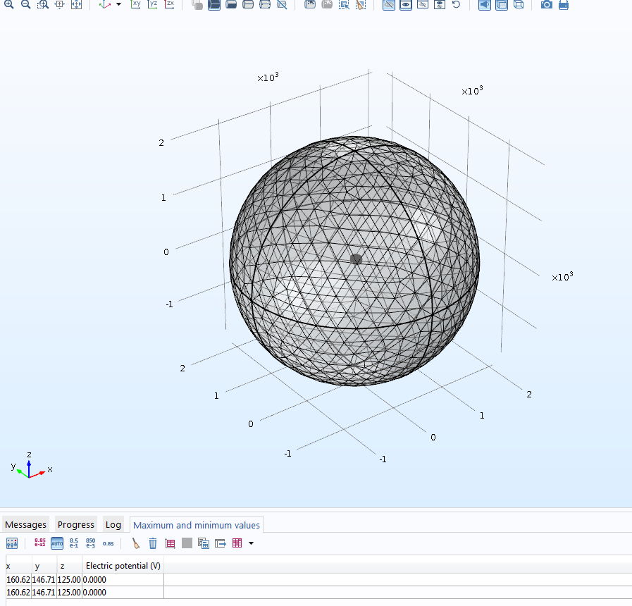

Hi Ivar
I have multiple layers surrounding to each other and I set mesh size normal for external sphere and set custom for other layers and changed min. element size according to warnings. eventually, there is no warnings, but when I plot max/min volume, it gives the same coordinate as shown in attached file. It means I should not trust my simulation results?
Any helps will be appreciated. Thanks
