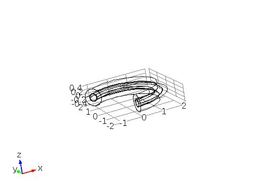

All Files are labeled accordingly. I've also attached the COMSOL file if anyone wanted to do some digging around in that direction.

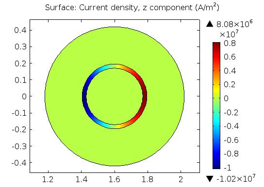

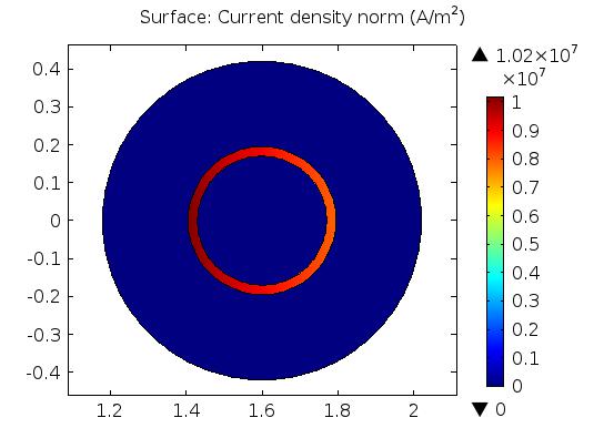

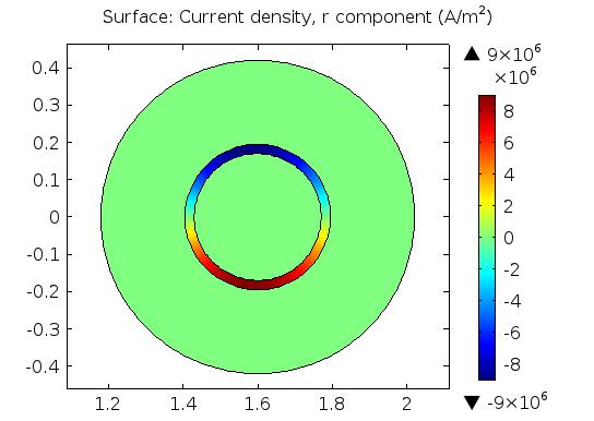

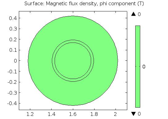

The problem is that there is current flowing in this torroid in the r and z directions in a manner that should create a B field in the center of the torroid. Are there some electromagnetism/COMSOL mistakes that I'm making is or is the program giving me errors where it shouldn't be (I'm sorry I'm new to COMSOL). I appreciate everyone's help, thank you very much.
Equations:
current_theta*(rad_major-rad_coil)/r*z/sqrt(z^2+(rad_major-r)^2) (r direction)
current_theta*(rad_major-rad_coil)/r*sqrt(1-(z^2/(z^2+(rad_major-r)^2)))*sign(rad_major-r) (z-direction)
