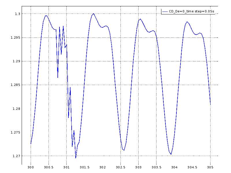

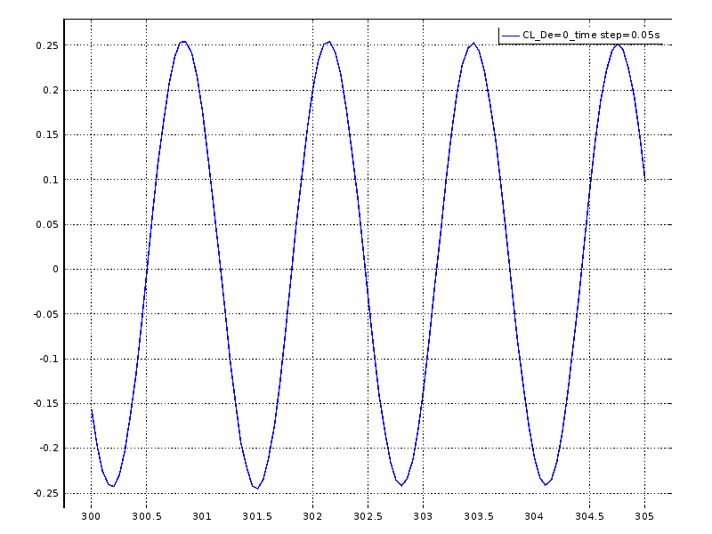

I got the attached results for lift and drag coefficient using "reacf()" function.
Please take a look at them.
I guess I should decrease the time step further.
Regards
Iman

I did that. I can also use Lift coefficient graph to find frequency.

The CD graph is so erratic as you see in attachment. I don't know why?
Another problem is that the average Lift coefficient is not exactly zero. it seems the field is not perfectly symmetric, but as I checked It is totally symmetric .
