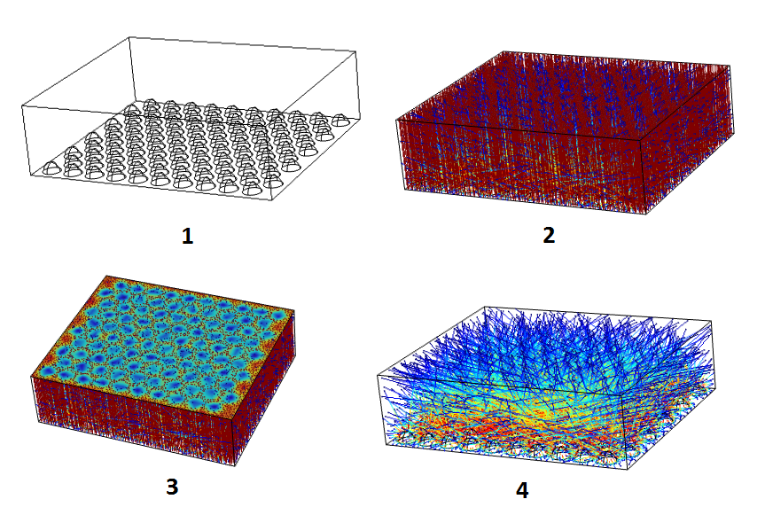

I am trying to find the way to calculate the scattering cross section or diffuse coefficient for glass surface with hexagonally packed micro lenses.
In other words, I just need estimate the light scattering of such a surface.
I try to use Ray Optics Module since my lenses (10um in diameter) much smaller then wavelength (400um-800um).
I have built the 3D model and got 3D distribution of light rays.
How can I calculate the amount of rays whose intencity remain the same (red rays on pic. 2)?
Please, let me know if someone know another method of light scattering estimation.

well I wondered about that :) in that case cannot you just analyze a "section" (one lenslet region) and duplicate that ?
That's why I've decided to use ray physics. But I don't know how to get numerical results.
I think, a good way for scattering estimation is calculating the ratio of total amount of rays to rays whose intensity and direction remain the same.
How can I calculate the amount of rays whose intensity remains the same?

isn't this the same as saying, if one have a flux, of given properties, traversing a Boundary, then one get the total flux by integrating the flux (boundary density) over the full Boundary, possibly also by integrating over some other property (i.e. wavelength) to get the full contribution.
So if you now want to limit the flux variation region with respect to some particular property "I0" you integrate the flux, over you Boundary, but bounded by your limits (i.e. lower_limit < I0 < upper limit) via for example a Boolean expression.

I have some doubt. If I have solve the problem which involves light in visible range (400-700 [nm]) and interaction with lens having dimensions (in micron). So how someone can solve the problem of focusing through lens and other related problem in Wave optics or RF module because in this case meshing would become a huge issue.
I could be wrong, but i think the example of modeling Czerny-Turner Monochromator would be helpful for you. (www.comsol.com/model/czerny-turner-monochromator-19061)
