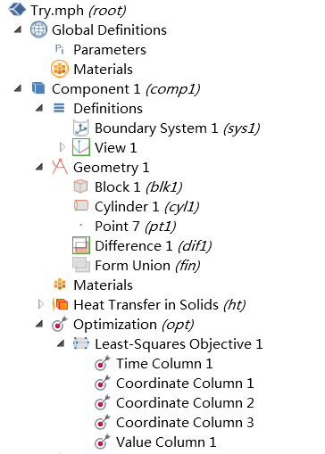

How to express the temperature series of a point at Optimization Interface?
Posted 2015年12月28日 GMT+8 12:10 Heat Transfer & Phase Change, Optimization 0 Replies
Expression -Value Column-Least Squares Objective-Optimization (see the attached picture):
How to express the temperature series of a point calculated by the Heat Transfer interface?
My goal is to obtain the convective heat flux coefficient between the curved side surface and air based on the monitored temperature series of the blue point (0.2,0,0.5).
Please help me solve the problems. Thank you very much.
