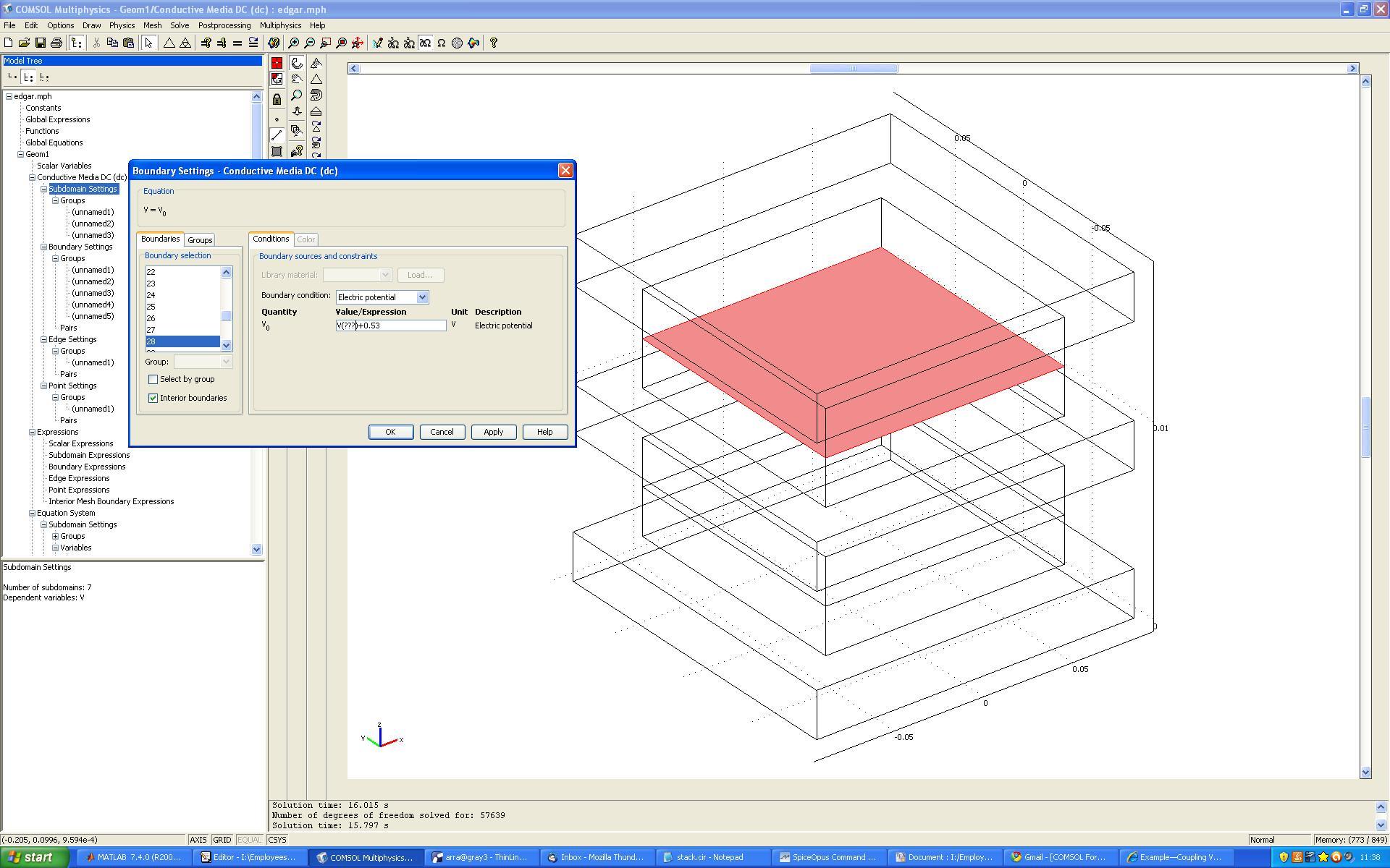

How do I enter the following BC: PlusU2 = V(MinusU2) + deltaU2.
The attached screen dump explains my question. Boundary 28 corresponds to PlusU2 and boundary 25 corresponds to MinusU2. For simplicity deltaU2=0.53.

Anders,
your expression would be V(x, y, z)+0.53. For (x, y, z) you use a point on your MinusU2 boundary or in the corresponding electrode subdomain. The variable V is the variable for electric potential in COMSOL 3.5a. You may need to check if it is the same in V4.0.
