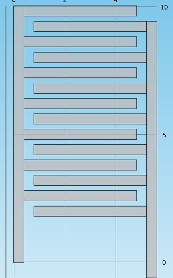

Im a graduate student at Hogskolen i Vestfold in Norway. As a part of my project I need to make a model of a capacitance sensor that is based on thin film Au electrodes on a Pyrex substrate covered with PTFE film.
The problem is that when I build electrodes with their real geometry I am unable to mesh them. The electrodes have a very, very high aspect ratio being only 100nm thick but about 10cm long. Meshing this as a free tetrahydral mesh takes unreasonably long - 2-3% per hour(never actualy finished meshing), so I tried using boundry layer meshing: selected boundry layer from mesh tab, selected the domains I wanted to mesh that way, on boundry layer properties selected the number of boundry layers to be 1 and first layer thickness equal to layers total thickness - 100nm. Meshing goes faster but still freezes at about 30% of creating innitial free mesh.
When I set the electrode thickness to a greater value like 10-100um instead of 100nm the model meshes with no problem and produces plausible C values.
Im confused... Is there any way to mesh this problem? The interdigital thin film electrode geametry is in the picture attached.
Any help apreciated.
Cheers!
- Fjodor

Well why should you mesh the film in it thickness if it is really so "thin" ?
Do you really want to analyse what is happening in the thickness of the film ?
If not, try the thin film boundary layer BC, see the doc
The true difficulty is when you have more than 1 thin film stacked on the same boundary (currently, from my knowledge, not implemented in COMSOL)
Then when you have "simple" square/rectangular geometries, it's often easier to leave it a s a series of adjacent rectangles, with some common interiour boundaries. Then you can easier handle the meshing sequences.
Lykke til

Thanks for the reply!
I dont actualy need to solve for what's going on inside the electrode - just the capacitance and how capacitance will be effected by placing things on the sensor.
I've checked the COMSOL help search and the doc folder - didn't find much. The knowledge base example 902 was some help but Im quite new at COMSOL and can't find how to make a composite object from two geometries...
Would this work if I just make the substrate a composite object with 2D electrodes on top of it covered by the PTFE film(this film serves as a dielectric)? If so, how can I create a composite object in COMSOL 4.0?

you have the model library thin_film_resistance model
So I assume, from the understanding of your comments, that you could probably get away with a 2 laer structure (+ surrounding air/vacuum) of bulk material below, a surface/boundary cutout region for the thin metallic film, and some thin domain/volume on top for the PTFE

Yes, the structure is basicaly as you describe: substrate with faces/boundaries to represent the thin film electrodes with a layer of PTFE on top, surrounded by air.
To find that model...

its in the model library, but you should have other similar ones on the main COMSOL web site too, try a search
