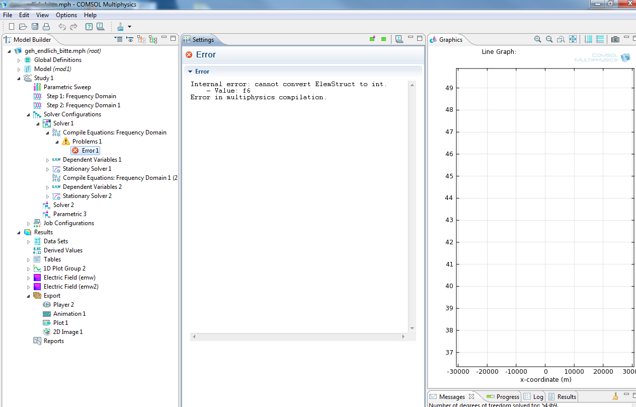

Posted:
1 decade ago
2013年10月29日 GMT+8 22:42
Hy...
I am getting the following error: internal error cannot convert elementstruct to int
Can i know about the remedy. I changed the mesh size also but it didnt work.
Hy...
