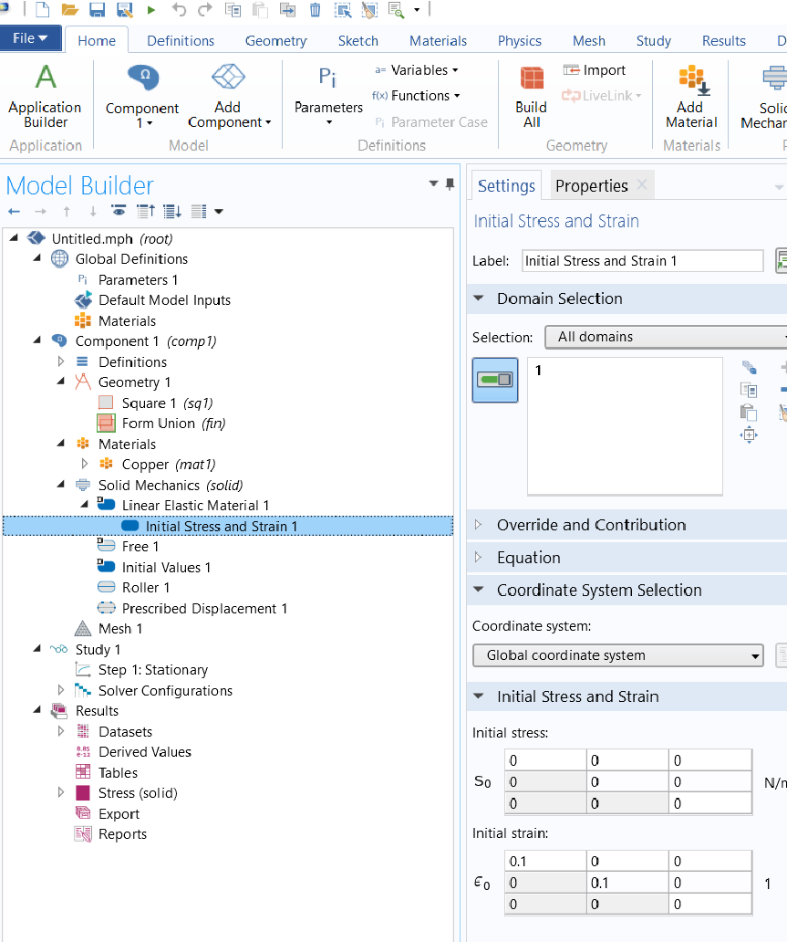

Hello Mohammad,
Check under File > Licensed and Used Products, whether your license includes the Structural Mechanics Module, the MEMS Module, the Acoustics Module, the Multibody Dynamics Module or the Metal Processing Module. If it does, you will be able to add an "Initial Stress and Strain" node to your model by right click on the Linear Elastic Material node in the Model Builder (See attached screenshot). If it does not, consider contacting your COMSOL representative to add one of those products.
