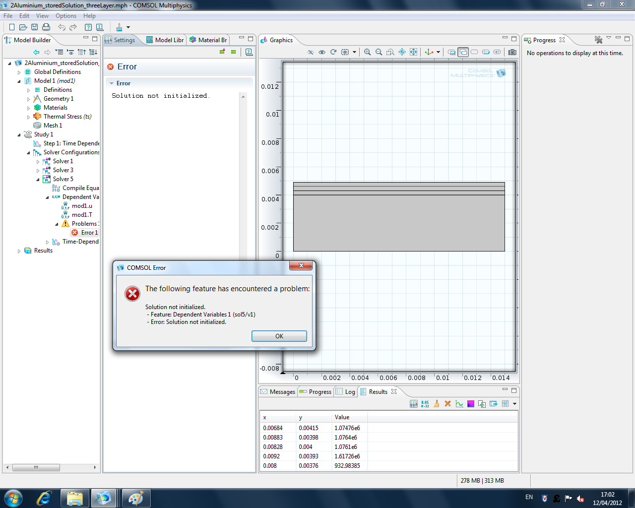

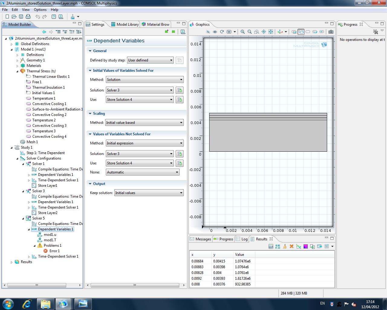

I have attached the error file(P4) and the settings I have used in dependent variables.
I was trying to store the solution of the 1st layer then use it in 2nd and then store that and use in the third, but got this error. I had got this error even when trying to use stored solution for 2nd layer but it worked later and don't know why its not working now.
I have many doubts,
1. whether the settings I have used in the Dependent variables correct?
2. Should I add one more Thermal stress model to the Tree or can I just add the boundaries of new material in the already existing 'Thermal stress' of the previous one?
3. Should I remove the 'Temperature' that I had given to the top boundary line of 1st layer when trying to simulate for the next one, (when solution from 1st one is stored does it take the end temperature of the top boundary line of 1st layer for the simulation of next layer so that I can remove the temperature Boundary condition)
4. When trying to compute, should I click on 'Compute' under the particular Solver I want or to the main Study?
5. How is the Time change affected, If I have time of (0, 5, 300) for the 1st layer & want to see the change in next 200 seconds after adding the 2nd layer should I change time to (0,5,500) under 'Time dependent solver' of particular solver (in my case Solver 3 or 5 in picture)
how does this time work?
Should it be of range (0,5,200) or (0,5,500) if I want to see the changes of the next layer in next 200 seconds after the 1st layer analysis?
