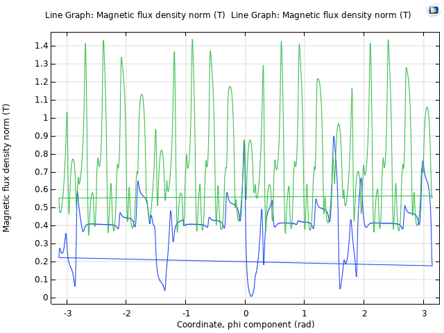

Thank you, that did it. However, when I plot wrt angle, the startpoint and endpoint is connected with a line. See attached. Any ideas on how to get rid of it please?

If you don't like seeing the return line, there are various solutions to that. You can always export the plot and use a different plotting tool. You can set the options so that you simply plot the points and not any line that connects them. Or, you can create a circle with a tiny gap in an appropriate location, so the plot doesn't hit the double-valued-angle point twice. Or you can plot your quantity vs arc length, but then scale that x-value so the arc length runs from 0 to 360 units (thereby creating a 0 to 360 deg plot). I think there are several other ways. Don't be afraid to experiment a little!
