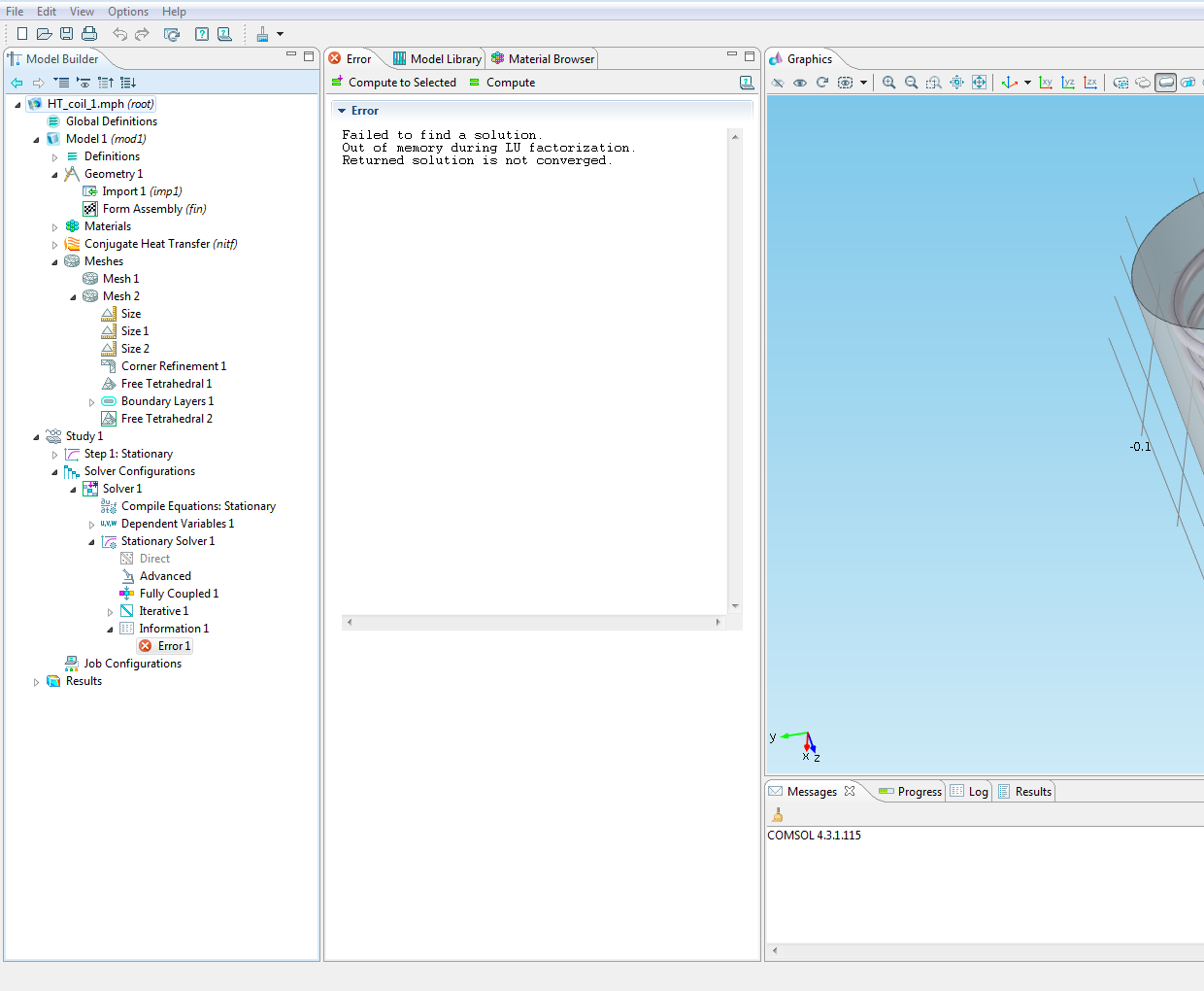

When computing recently a 3D geometry with conjugate heat transfer module, I got this error:
"Failed to find a solution.
Out of memory during LU factorization.
Returned solution is not converged."
Please what does it means? And how to solve this kind of error.
Thanks in advance for your answer.
A. Fopah Lele

Well, this means you need more RAM on your system if you are going to solve the problem as is. Required RAM for solving is directly related to the number of degrees of freedom you are solving for which is directly related to how fine of a mesh you are using and how many physics variables you are solving for (amongst other things).
A couple suggestions for overcoming this error:
1) Decrease mesh resolution -- fewer elements means fewer degrees of freedom
2) Consider if your model has symmetry then reduce your geometry and apply symmetry boundary conditions
3) Switch from a Direct solver to an Iterative solver -- Direct solvers use more RAM
Hopefully at least one of these tricks will be the answer for you.
