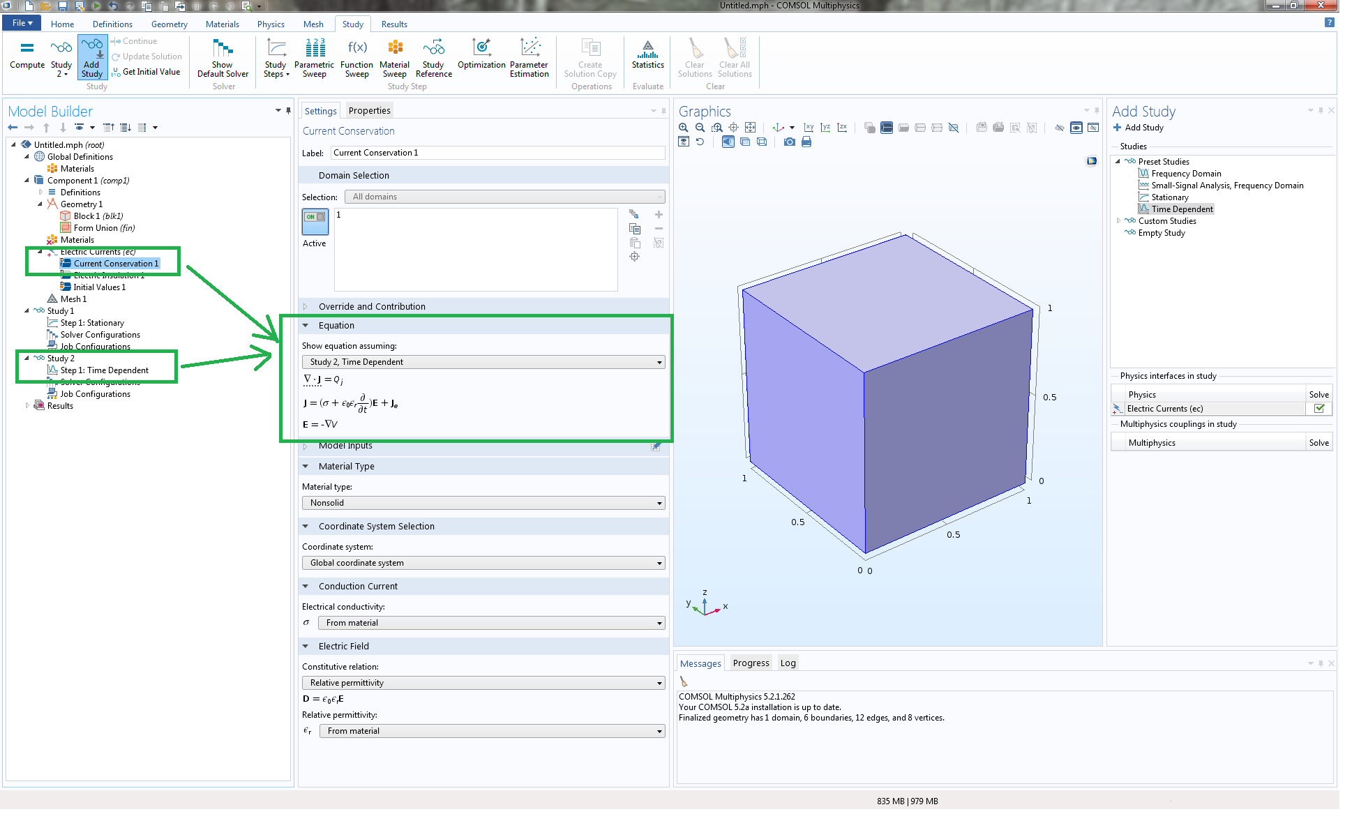

Posted: 7 years ago 2017年2月28日 GMT-5 08:23
Hello Carmen,
As long as you plan on solving the Electric Currents in a stationary way, only the conductivity is needed. The relative permittivity is needed when you do a time-dependent study, see attached screenshot.
Best,
Hello Carmen, As long as you plan on solving the Electric Currents in a stationary way, only the conductivity is needed. The relative permittivity is needed when you do a time-dependent study, see attached screenshot. Best, Jeff
