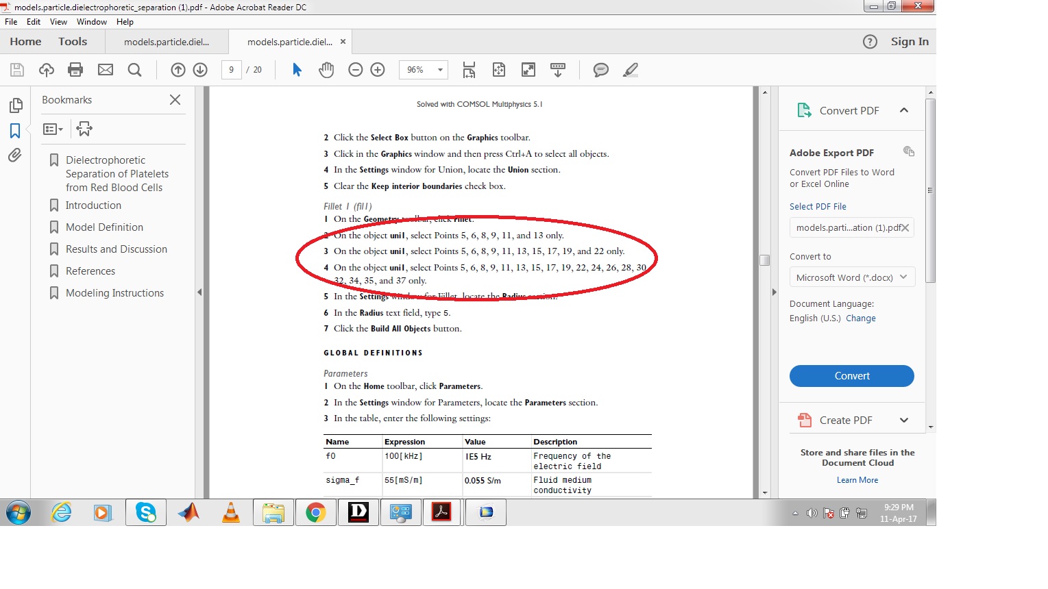

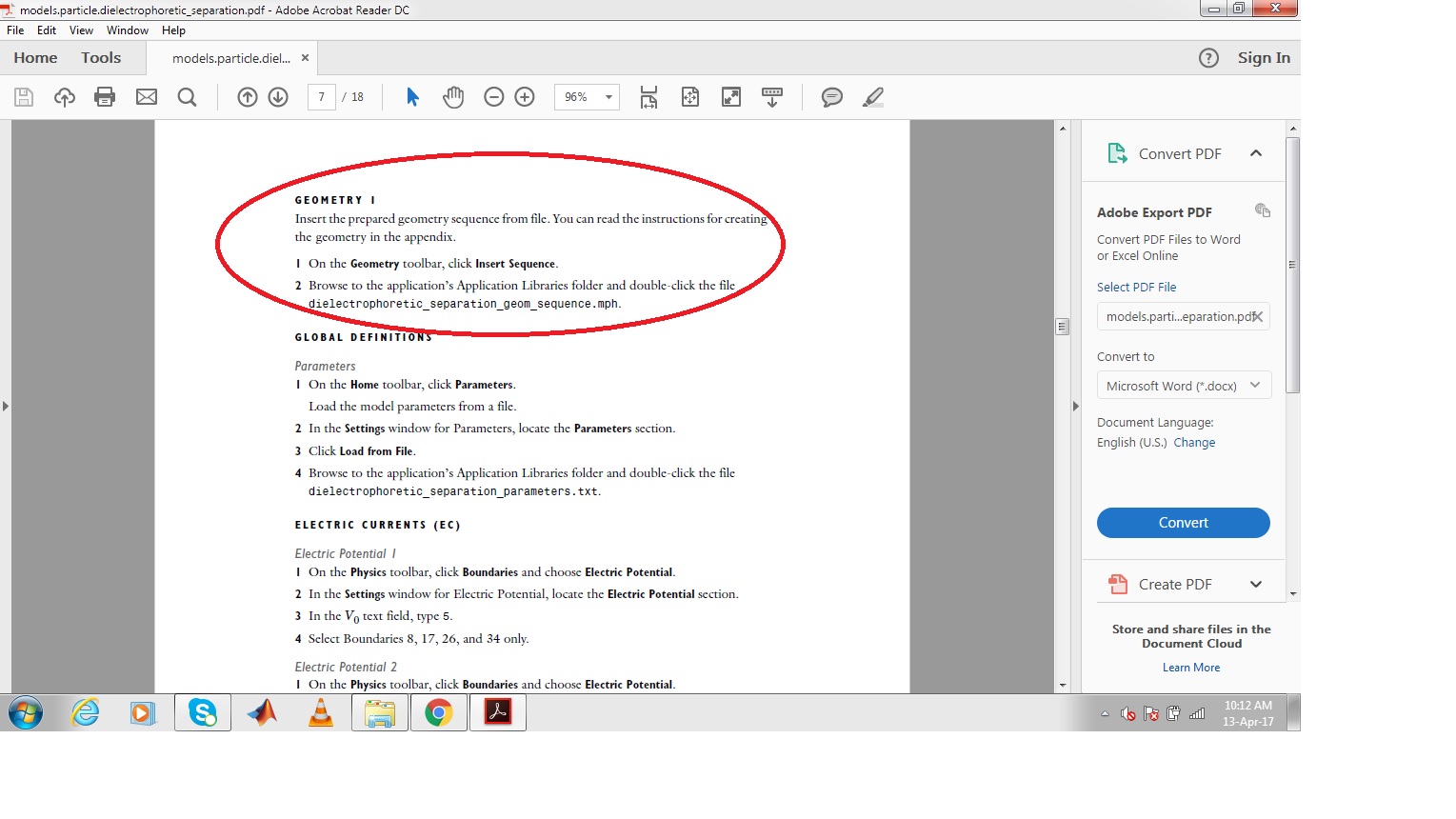

Hello Jeff,
Thank U for your favourable response. But I would like to obtain the set of instructions for Version 5.0 as I have very few days left for the submission of my project.
And in both the versions 5.2 and 5.2a, the manual asks to simply upload or 'Insert Sequence' a file 'dielectrophoretic_separation_geom_sequence.mph' from Application Libraries folder, which I obviously don't possess as I have version 5.0. Also I want to know the geometry behind it, which will otherwise not be known if I simply upload a readymade file. Because I have to explain the geometry as well to my guide. I am attaching the screenshot as well as the file of the manual for your reference (Pg 7, GEOMETRY I paragraph).

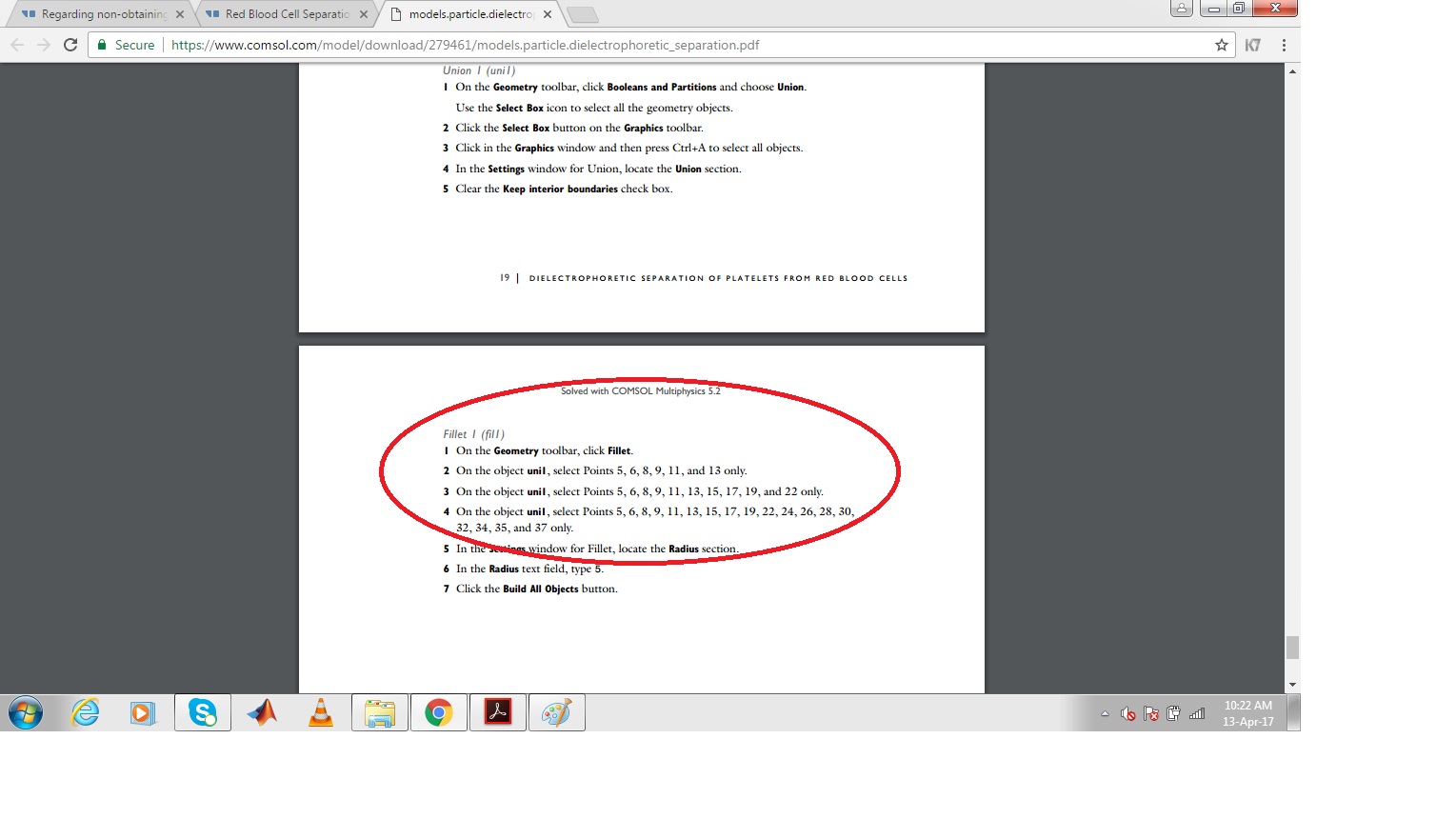

Also, as per your instruction, I have downloaded the manual for Version 5.2, as you have said that the instructions have been corrected. I am attaching the same here (Fillet I instuction Comsol 5.2.jpg. Also Pg.20, Fillet I paragraph). But all the instructions are same as that of 5.1.

You misread. My post indicated that the version 5.2a instructions are corrected. My post above does not mention version 5.2. You will find that the version 5.2a instructions for Fillet 1 are corrected (See the file you attached just above).
Please note also that when you insert a geometry sequence, you do get access to all the steps that were used to create the geometry in the Model Builder. This is not to be confused with importing a CAD file: in that case you cannot see how the geometry was created.
