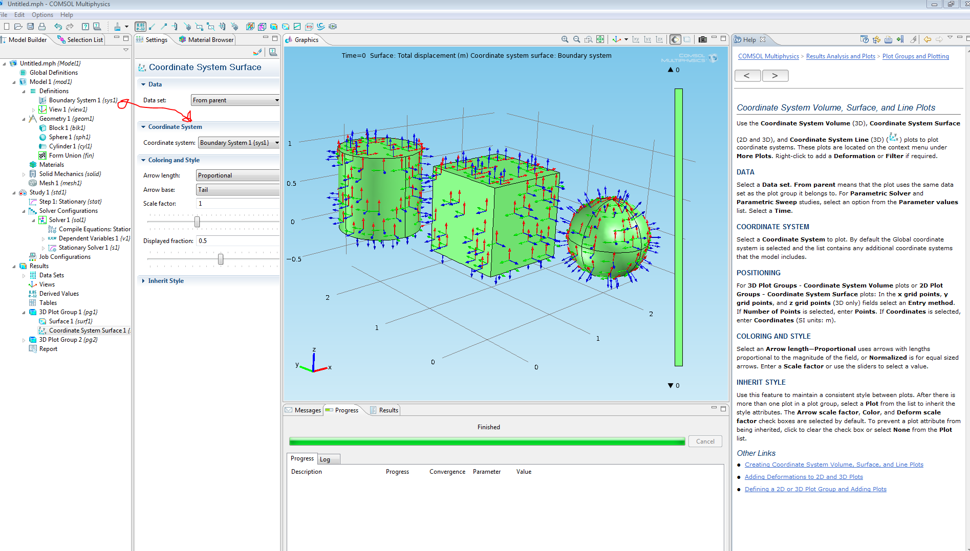

In V4 we have the default boundary coordinate system t1, t2, n (in 3.5a too if I remember right) see below
indeed sys2.T11 are part of the transformation matrix of a "user coordinate"system that one can define in V4. The only thing about using them I haven't found the "true" content described in equations, only in "principle", and I'm slightly susceptible, I like formulas that are precise and univoque (thats perhaps a French word, not sure what is the corresponding English / American one ;)
Now I have never trusted that s1, s2 were uniquely normalised, at least there are several warnings about it in the 3.5 doc
