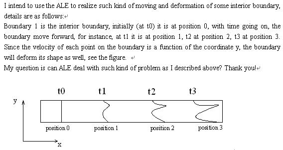

Can ALE deal with such kind of moving and deformation of some interior boundary?
Details please see the attachment, thank you!

I would say that is what ALE is for, at least from what I understand of your image
Hi I would say that is what ALE is for, at least from what I understand of your image -- Good luck Ivar

Thank you, Ivar!
As time going on, the deformation maybe become too large (a limitation of ALE), are there any good method to deal with this situation?
[QUOTE] Hi I would say that is what ALE is for, at least from what I understand of your image -- Good luck Ivar [/QUOTE] Thank you, Ivar! As time going on, the deformation maybe become too large (a limitation of ALE), are there any good method to deal with this situation?
Posted: 1 decade ago 2011年3月1日 GMT+8 22:39
Yes: stop, remesh and restart. That feature was there in 3.5a not sure how its done in v4, havent used it so far, or perhaps it only comes in next release I do not know, check the doc

I would assume it will become messy with large deformations. Can't you use Level-set methods?
Comsol 4.1
Ubuntu 10.04.1
[QUOTE] Details please see the attachment, thank you! [/QUOTE] I would assume it will become messy with large deformations. Can't you use Level-set methods? -- Comsol 4.1 Ubuntu 10.04.1

Thank you for you answer!
Yes, I have considered to use the Level -set method. But the Level set method in Comsol is designed for the multiphase flow, my model is solidification (phase change), and the moving interface is the phase change region. If I want to use the level set method (coupled with heat transfer), I need to know the heat flux difference across the moving interface and the temperature of the interface should be fixed at the melting temperature, I don't know how to realize these two points (or maybe comsol cannot do these). If you have any good suggestions, it would be appreciated greatly!
[QUOTE] [QUOTE] Details please see the attachment, thank you! [/QUOTE] I would assume it will become messy with large deformations. Can't you use Level-set methods? -- Comsol 4.1 Ubuntu 10.04.1 [/QUOTE] Thank you for you answer! Yes, I have considered to use the Level -set method. But the Level set method in Comsol is designed for the multiphase flow, my model is solidification (phase change), and the moving interface is the phase change region. If I want to use the level set method (coupled with heat transfer), I need to know the heat flux difference across the moving interface and the temperature of the interface should be fixed at the melting temperature, I don't know how to realize these two points (or maybe comsol cannot do these). If you have any good suggestions, it would be appreciated greatly!

I see. I am not sure that mass/energy is conserved along level-set boundaries in Comsol, but I can guess can be tough. In that sense, ALE is much better choice. If you have large deformations then you will need to stop the simulation and do a remesh (you can do this automatically via Matlab). It is possible and not a very big hassle. I remember there was such an example on comsol website (user models), but it works for old comsol v3.5a. At least you will get the idea.

Thank you, Danial!
I searched the remesh example you said on comsol website but failed to find it. Do you still remember where it is ? Thank you!

You're right. It is not there anymore.

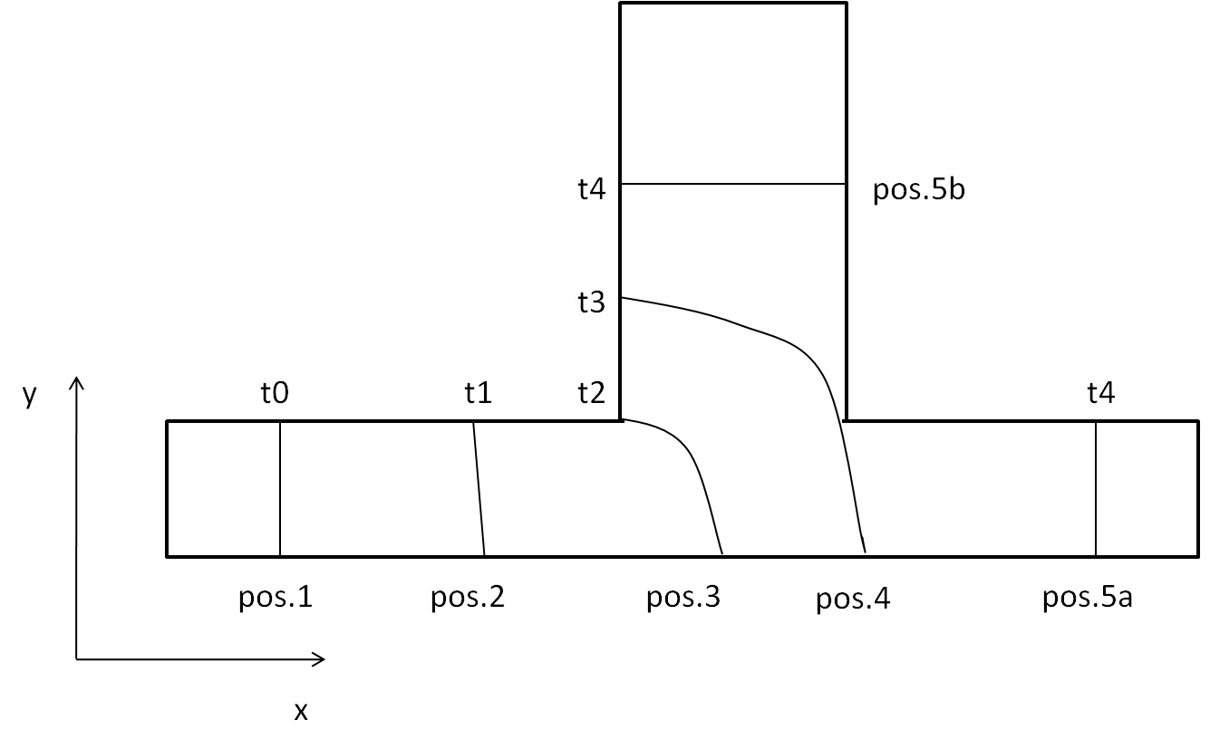

What might be even more interesting is whether you can simulate a moving phase front which is "going around a corner" or passes through a T-junction or bifurcation. In that case the original boundary has to split up in two separate ones. Does anyone have an idea if it is possible to use the ALE method in those cases? (See similar picture as before in the attachment).

To my knowledge, ALE cannot deal with such kind of topological change problem.

I also got a reply from COMSOL support and they prefer to use level-set or phase-field in such a case. However, than you run into the difficulties you mentioned before. Have you solved the issues for the unknown heat flux difference across the moving interface and the fixed temperature of the interface? If you know how to implement these, it would also be of great help for me!
