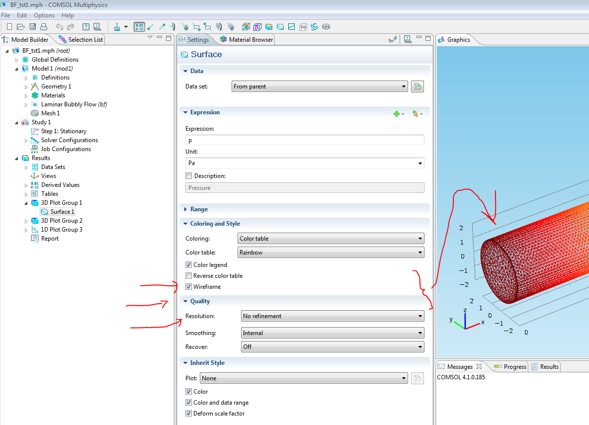

I'm not sure about the interpolation level (probably 2nd order or linked to the shape function order) but the points you define are interpolated from the closest mesh points (from my understanding)
To visualize the mesh points and edges, use a the WIREFRAME rendering for your results, with no smoothing enhancement (see under Quality in your plots node)

Thanks you Ivar.
I guess that people at COMSOL should know or can I find this information somewhere ?

Ivar,
I do not have any Quality option in the node menu.
Thanks for your help.

I do see below

thank you very much Ivar.
