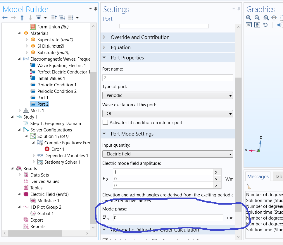

I want to know how we should set a right value for "Mode Phase" parameter (circled in the attached picture) when defining a periodic port in analysing a periodic structure?
I have a problem that is I feel one of the ports that I define in my simulation is not matched so I see standing waves in the second side of my simulation set up. I was wondering if this probem arises due to "Mode Phase" in the port definition.

In your picture, it seems that before doing the Frequency Domain step, you did not put a Boundary Mode Analysis. I don't know if it helps, but it should at least ensure that comsol finds out how to send to mode.
