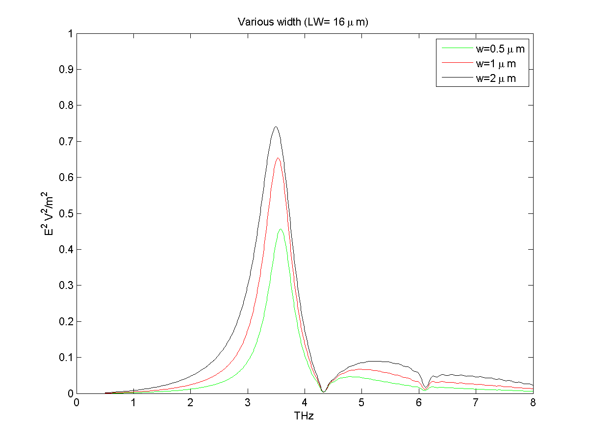

I'm an electronic-engineering student at the University of L'Aquila (Italy), and I'm quite new to COMSOL. To get practice with COMSOL I was told to replicate a simulation done with another simulation program. My goal is to simulate a sort of Terahertz filter, made of a thin layer of Aluminium ad a Silicon substrate. I attached the model I'm working with.
After days of trying, I got stuck because I cannot have the same response (in terms of E^2) as the one i get with the other program, with the same geometry, and same materials. I attached this response too.

- How Periodic Condition can be applied to my model?
- The different response is due to wrong materials properties?
- Have I made any error in the physics (emw) branch description of the model?
- There is a way to plot the same expression (E^2) to have better comparison?
