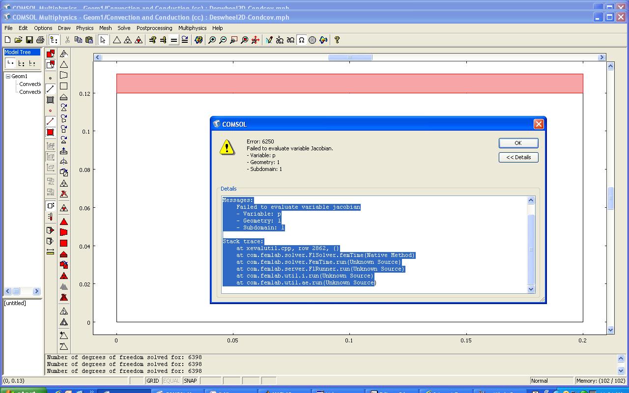

6250 = Failed to evaluate variable Jacobian.
This usually means that you have an unknown funcion or expression in some of your material parameters or boundary conditions. If you click "Show details" in the error message, there will usually be a clue to which expression was not recognized.

Thanks for the clue. I checked the 'Show details'. It is in the attched file. It is not clear which is the problem function. Could you have a look at it

Thanks for reply. To tell more about the problem, I have attached the model file.It has 2 subdomins, 1 with convection and conduction , other with convection and diffussion. There is no parameter denoted with p. It shows error with p.
