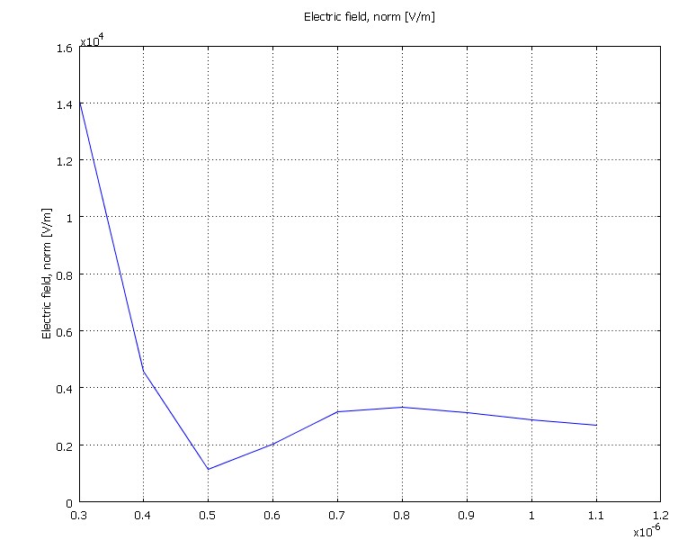

I've got exactly the same problem - I'm trying to model nanostructures and also get the peak for lower wavelengths. I tried doing the calculation without anything in my box and get the same peaks...either we are doing something wrong or there is a bug in Comsol.

making geometry withouth nanoparticle/s that behaves properly I have found representing quite a chalenge. (What is meant by behaving properly is also a question, but let's say if you find scattering crosssection of some metallic sphere and if it is similar to what you expected, than might work for something else...) I must admit that I haven't spend too much time on trying to figure out what is the recipe fot making it right, but there are some hints that might help.
1) PML issue: You can play with few things regarding PML: Absorbing in r (x,y,z) direction parameter, which represents damping of scattered fields, then geometrical thickness of PML, then meshing inside PML, and at last, position of your PML regarding to scatterer.
After disscussing it with some friends, and comsol support, I cannot conclude anything consistent, but that they are not sure also how to optimize it, or they cannot explain it in easy words. You can find some people making their own PML profiles by changing this 'absorbing parameter' into some analytical formulae, comsol support says you should keep that parameter to be equal to lambda_rfw (why is that, I am not quite sure) and it sometimes works sometimes not. About meshing density and separation from the scatterer also I am not clear, sometimes if I increase meshnig it gives me no improvement (meaning that meshing density is fine), and moving PML further increase my models volume, and than again actuall tickness of PML affects ratio of performance/memory waste.

I have been playing around with the size of the PMLs as well as using well-defined ports instead of automatic plane wave excitation, and I always get the same initial peak for low wavelengths, with or without object in my "box" (see the attached Strangespectrum.jpg). For the attached model, plotting the near field spectrum at point (0,0) results in another peak at higher wavelengths, which is the one I would expect, I think. But I cannot think of any explanation as to the first peak....

Hi! I have been playing around with the size of the PMLs as well as using well-defined ports instead of automatic plane wave excitation, and I always get the same initial peak for low wavelengths, with or without object in my "box" (see the attached Strangespectrum.jpg). For the attached model, plotting the near field spectrum at point (0,0) results in another peak at higher wavelengths, which is the one I would expect, I think. But I cannot think of any explanation as to the first peak.... Kind regards, Martina

I think the background material is easy to implement (as long as you look up its dielectric function) once it works for the vacuum. Which it doesn't, at the moment, at least not for me....
