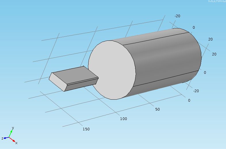

Hi Ivar,
I tried somethings but I didn't manage to complete it.
A cone could be set up on the cilinder.
But how can I change the upper surface of the cone (I tried intersection but this must be done in a workplane? how can I get the two surfaces in the same workplane?)
I only capable of having a round cone.
Can I extrude the square surface into a round surface over a certain distance?
Hi Ivar,

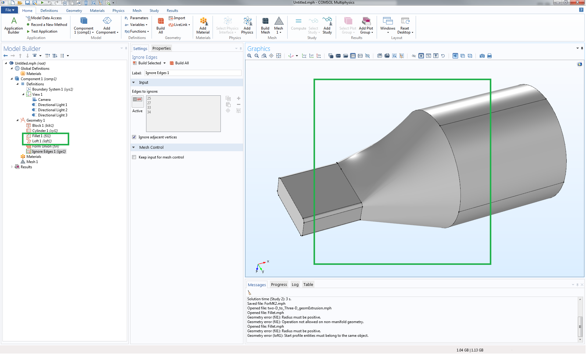

Jeff Hiller
COMSOL Employee
Posted:
10 years ago
2015年12月4日 GMT+8 23:31
The Design Module (which did not exist when this thread was started) includes, among other things, two capabilities that makes creating this geometry a cinch:
- 3D filleting
- Lofting
I am attaching a screenshot illustrating those capabilities on your geometry.
Best,
Jeff
- 3D filleting
- Lofting
Best,
Jeff
