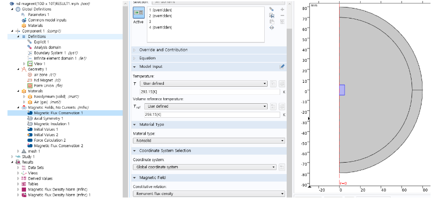

I designed the nd magnet.
In magnetic flux conservation 1 , the z axis was set to 0.5030T.( Nd magnet)
In magnetic flux conservation 2, air domain was set to relative permeability. (Air zone)
Infinite element domain1 is set at the boundary.(5mm edge layer of air zone)
but if the air region size is made different, the magnetic field value coming out of the center of nd magnet surface becomes different.
I set an infinite element area, but why does the value of the magnetic field change?
Is it because the internal meshing has changed?

The default external boundary condition (without Infinite Element Domains) is to have the magnetic flux lines tangential to the boundary, artifically containing the field within the confines of the model. An Infinite Element layer, is an effective way to make the effective air domain much much larger, and the far field has virtually no effect on the near field.
See attached doc for images of this. The top image uses default air domain, the second has IE domains outside of the visible air domain...
