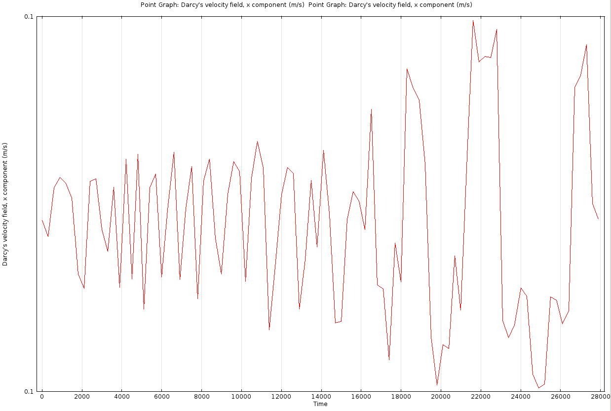

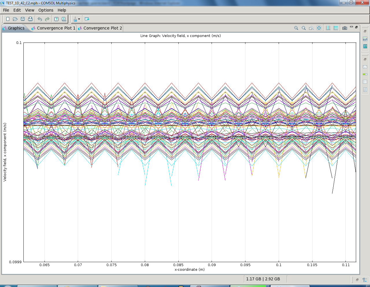

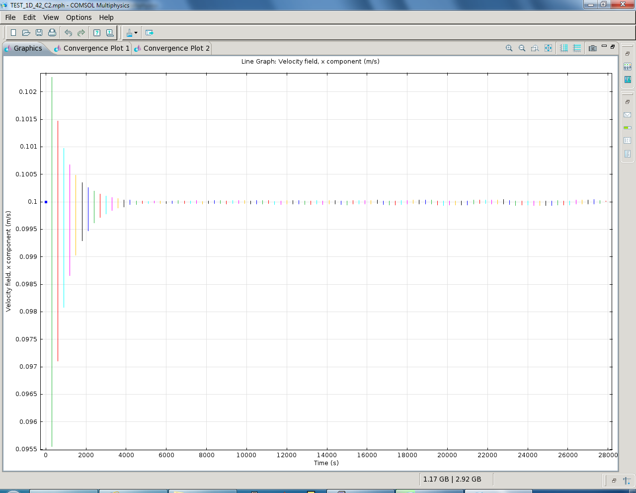

A small question this time: Does anyone know how to remove the crazy (!) oscillations that occur in my velocity profiles (and all other graphs dependent on the velocity) ?
I am using 1D Darcy, Transport of species in porous media and 2 heat transfer modules. Changing solvers, timesteps, boundary conditions and number and type of elements has no effect. If I take the gas viscosity (mu) constant instead of using a (linear, temperature dependent) function, it is less bad, but still there.
So, any ideas? (please view attached picture to see what I mean ;) )

Without seeing your model I can't say much about it, I also don't have experience with the kind of simulations you're doing.
Maybe you need to refine your mesh?
Check the convergence plots as well, see if you see something weird.
I would suggest to do a very basic simple simulation and see if you can reproduce the artifacts.
-Jaap
P.s, nice name.
What I tried is to get finer mesh, and see if oscillations have decreasing magnitude.
Why not trust a result because there is oscillations ? I would rather propose to try still to understand why, so you get around quicker next time.
Oscillations can come from several issues, such as (but you seem to have ruled out these) mesh density and time stepping, but also from numerical issues such as
underflow overflow, hence from the scaling of the variables. See also the KB on the numerical stabilisation (www.comsol.eu/support/knowledgebase/1104/),
yet another source. And sometimes one forget that a transient or time series solver adds in the inertial terms rho*d^2_u_/dt^2, so with non-coherent initial
values and some BC values one can hit the model like a structure with a hammer, it will resonate quite some time, if it even settles once ;)
Finally,what I have observed when fiddleing with simple PDEs, is that you sometimes get a spiky solution with extrema on the mesh nodes, and that follow the mesh
change, these can come from insufficient BCs so you have 2 solution of your equations and COMSOL is oscillating between both. In fact you get two solutions by
looking at the extremas (in linear discretization) for the same work ;) Probably, this is not your case here with the complex physics you have.

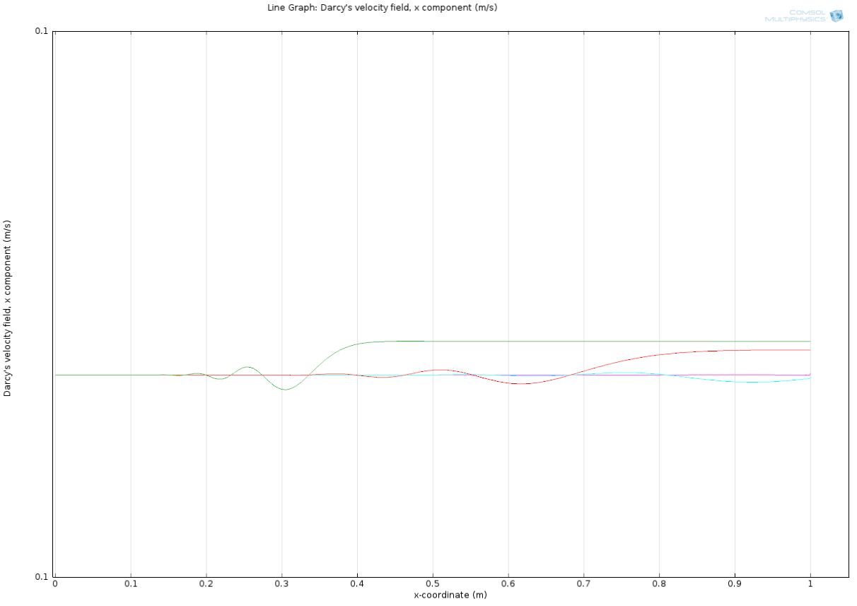

I have read the reference guide (again :P ) and I think I found the source of the problems (which I indeed to a certain degree managed to repeat in a simple model). The problem is that when the Peclet number is greater than 1, you are bound to get numerical instability. On page 354 of the reference guide a measure for instability is given:
Pe= (||v|| * h ) / (2 * c)
v is the convective velocity vector, h is the element size, c is the diffusion coefficient.
When Pe is greater than 1, and you have certain boundary conditions, you get instability.
Fortunately, they give the solution in terms of adding numerical diffusion which you can control under the 'stability' tab of many modules.
Unfortunately, such a tab is nonexistent in the Darcy flow module, the one that I am using of course, so,...I still don't really know how to get rid of this annoying instability.
They proposed to use more elements but it (my real simulation) is already slow with 250 elements, so using 1000's of elements is unworkable and I strongly suspect (based on testsimulations) that this will not work anyway.
My question to you all now is: any other ideas on how to solve this? And why isn't there any option for stabilization in Darcy / Transport of species in porous media ?

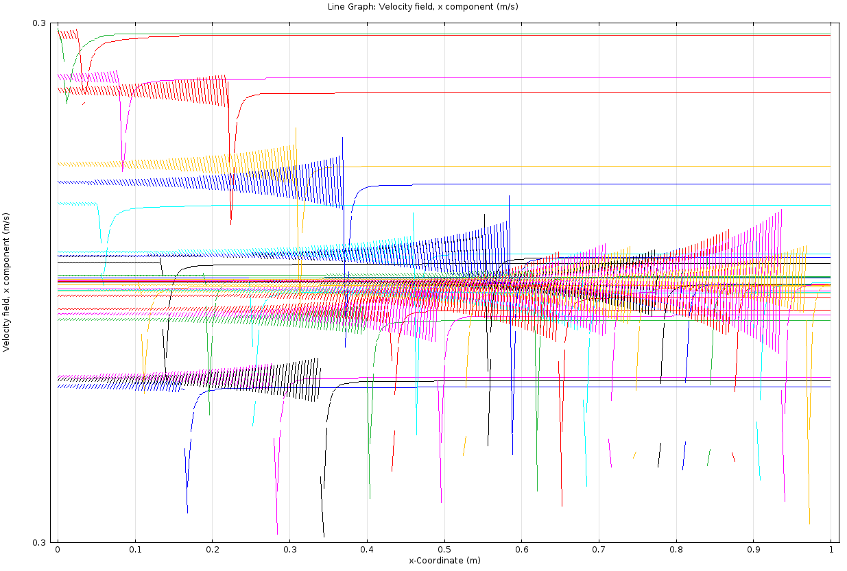

Please view the attached pictures and/or the corresponding attached models if you want to see it in actual action.
The first model is a very simplified model which does seem to show the same behaviour.
The second model is a stripped down version (to make it a lot faster to solve) of my actual model, which shows this behaviour very strongly.

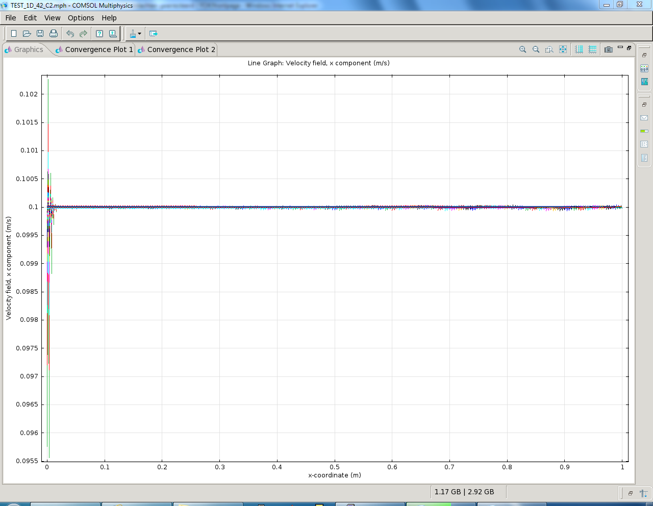

In your simple model refining the mesh does not help, and the oscillations nearly disappear after some time so they could be caused by a sudden change in loading in a transient analysis. If you try ramping up the C0,c2 inflow condition in the Species Transport and also the velocity condition in Darcy’s Laws with a fast acting step function, the solution becomes less oscillatory. I don’t know how much of that applies to your other detailed model. One more factor to investigate!

It seems you are right. I did more tests and must conclude that apparently the high Peclet number does not seem to be the problem in this particular case. I now used a stepfunction to increase the inflow velocity from 0 to v_in and this did indeed resolve the issue with the oscillations in the v plots.
However, I now noticed that the plot for the velocity is just a horizontal line (the v_in that I used as input), which means that apparently the inflow of mass (my drying reaction, input of H2O in gas stream) does not have any impact at all on the velocity. I dearly hope I did not miss anything fundamental or something, but it looks to me as if the increase in concentration/density does not reflect a change in pressure/velocity in this case, which seems wrong to me. Maybe the definitions of pressure in COMSOL are confusing me again.

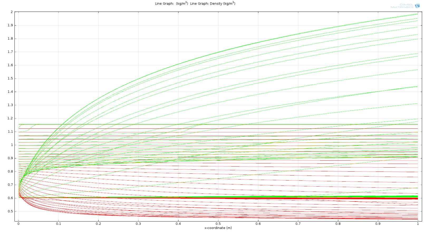

The water particle source increases the total amount of particles in the gas flow so, since mass is added, I would expect the Darcy velocity dl.u to increase. The mass increase increases the pressure, but since it is an open system, the velocity should increase instead, right? I get really different results for different settings for Darcy flow so I want to calculate it myself, but I am confused.
Ideas gas law states: PV=nRT, which leads to: PM=RhoRT. But of course this is a flow system and not a closed system, so actually some kind of dynamic pressure should be used.
According to Bernoulli P1 + 1/2 * rho_1 * v_1^2 (no change in height) = P2 + 1/2 * rho_2 * v_2^2 , but Bernoulli can only be used in steady state right (which this isn't)? And only at constant T as well, right? I calculated the total (absolute) pressure before as P_total=SUM[C_i*R*T] but that seems wrong (way too high), is it wrong to do this? How should I do this?

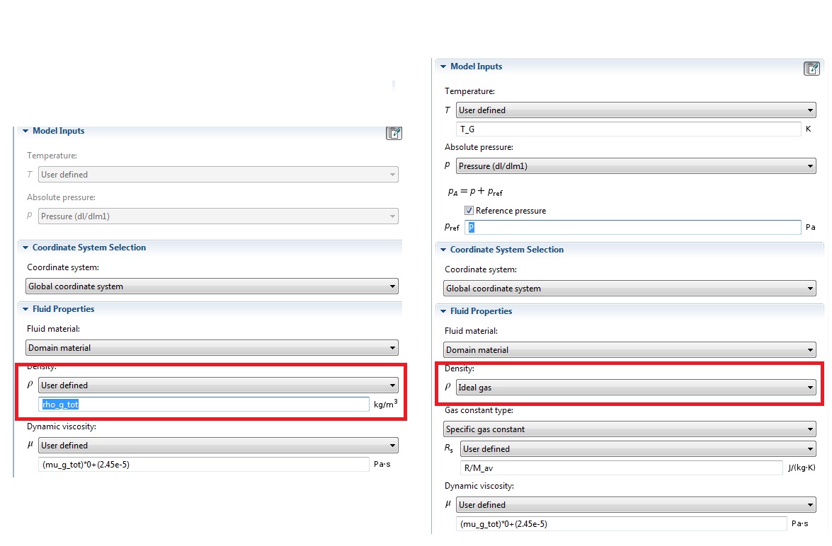

If I set Darcy density to 'self defined' rho using rho_total=SUM[rho_i] I can't set the pressure and temperature. But if I set the density to 'Ideal Gas', I get the P and T option.
(see Darcy_Interface_self_defined_rho_vs_Ideal_Gas.jpg).
This leads to very different results.
(see rho_g_tot_vs_x.jpg, rho_g_tot is green, dl.rho is red).
Why is that different, according to (rewritten) Ideal Gas Law, rho_i=Ci*Mi, right?
So why the difference? How then does Darcy calculate the density? I have checked the manuals but can't find what I am looking for.

1. rho_i = c_i*M_i is not "according to the ideal gas law", it's just a relation.
2. When I open your models, I can't access the equation view in the physics, even if my Options\Preferences... are set to show all/expand all. Is it also your case? If yes, you can't access the detailed equations and you can't see that Darcy's module calculates the density from ideal gas law in this way: rho = p/(RT) where R is the specific gas constant in J/(kg.K). Maybe it's a little bug and you should rebuild your models from scratch.
3. Regarding the difference between the ideal gas density calculated by Darcy's module and the density calculated manually by rho = sum(c_i*M_i) --> been there, done that! And I had weird results just like you. This is when we began to realize that solving the N species equations + the continuity equation made the problem overdefined.
In a way, you just proved it yourself: you used the sum of your species concentrations to calculate the gas density. From this density, you know that you can calculate the pressure with the ideal gas law. Now that you have the pressure, you just have to calculate the Darcy's velocity in a list a variable. The Darcy's velocity calculation is very simple, it's the same calculation as, for example, the heat flux that Comsol calculates when you plot a heat flux (q" = -k*d(T,x). You don't need a module to do that for you, and remember that the Darcy's module solves a form of the continuity equation, expressed with the pressure as the dependent variable, then it calculates the Darcy's velocity separately from the pressure.
