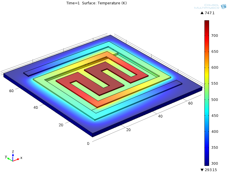

I have designed a MEMS micro heater for gas sensing applications. I have used joule heating and considered platinum as the material for the heater.
I have obtained the temperature and want to know the thermal expansion.
I have used solid mechanics and joule heating with thermal expansion but not able to achieve accurate results.
I am enclosing the file for the troubleshooter reference only.

TEM (solving for T, V and _u_) should do that.
TEM is a "pre" assembly of JH (T+V) and + Solid (_u_) or of HT (T) + EC (V) and SOLID (_u_)
check your dependent variables when you select your physics, and be sure you do not dedouble the SAME variable when combining physics
Hi TEM (solving for T, V and _u_) should do that. TEM is a "pre" assembly of JH (T+V) and + Solid (_u_) or of HT (T) + EC (V) and SOLID (_u_) check your dependent variables when you select your physics, and be sure you do not dedouble the SAME variable when combining physics -- Good luck Ivar

I checked those variables and all are right, still its not happening sir
and the model file is too long to attach (25 mb)
Please provide me your mail link
