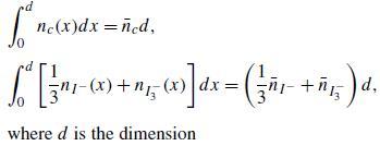

There are two integration in my model, which is shown in the attached picture. How do I input them into Comsol? Thanks.

You need to define domain (0,d), then set create a coupling operator on it.
Suppose intop1 is the operator. Then you have for the fist equation:
intop1(n_c(x))=ñ_c*d
I hope this helps.

Thank you, but where shall I define the operator intop1? Is it in the "Subdomain Integration Variable" submenu?
And where shall I input the equation?

I cannot input the equation as it appears, can I? I mean, you cannot enter "=" in an expression...

check how it's done in "An Integro-Partial Differential Equation" example. I think it has what you need.
