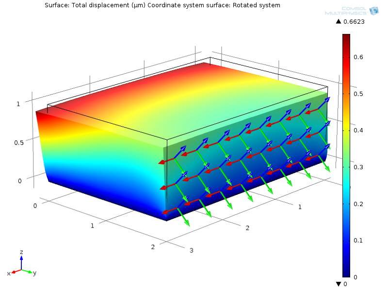

If I do a simple block model in 3D I can orient a Rotated system in 3D (with the Euler angles (0,-42.75°,0) and get your image vector orientation, with the electrodes in the X-Y plane at two different Z height locations. Then I can get a 3D X-Z plane (corresponding to your 2D x-y SAW plane) and see the PZT deformations.
this gives you strain matrices elements, in the local coordinate system, of the type
pzd.el11
(sys2.T11*uX+0.5*sys2.T12*(uY+vX)+0.5*sys2.T13*(uZ+wX))*sys2.T11+(0.5*sys2.T11*(uY+vX)+sys2.T12*vY+0.5*sys2.T13*(vZ+wY))*sys2.T12+(0.5*sys2.T11*(uZ+wX)+0.5*sys2.T12*(vZ+wY)+sys2.T13*wZ)*sys2.T13
But now to remap this into 2D with a 3D Rx rotation for a material plane coordinate system, I cannot find the COMSOL commands, and referring to "z" or "Z" in 2D brings an error message Z unknown
And the then the local strain matrices are
pzd.el11
(sys2.T11*uX+0.5*sys2.T12*(uY+vX))*sys2.T11+(0.5*sys2.T11*(uY+vX)+sys2.T12*vY)*sys2.T12
missing all coupled "Z" terms
So probably you need to write out manually the coordinate mapping in 3D and use that in 2D. But you can be inspired by the 3D model.

But a trick I always uses: plot the final direction of your coordinate system to check the orientation: for that you need to solve for the initial conditions, to populate the data set and result tabs, then add a plot - more - coordinate and select your user Defined coordinate system
