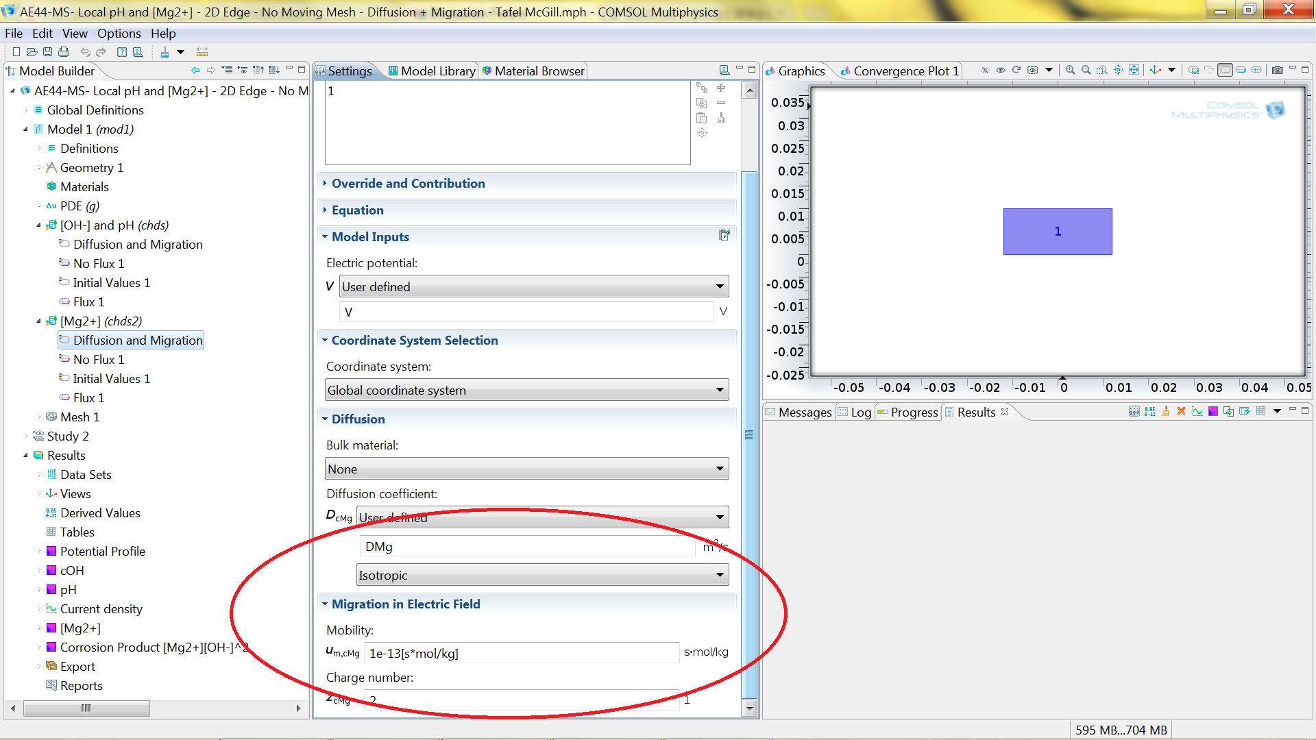

Unit of Ion mobility (Nernst Plank Equation)
In Nernst Plank equation, we must enter the mobility of one ion for the migration in electric field.
But in Comsol, the unit of the mobility is [S.mol/kg].
In the scientific articles, they use the mobility with unit [m^2/V/s]. [1]
So can Comsol staff explains me how to convert the mobility in science to the mobility in Comsol ?
